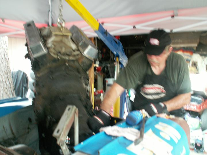

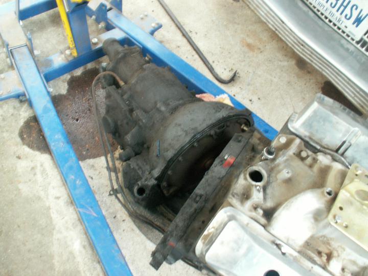

                        • 173rdherd
                          • 2211
                          #2937
ID:	862541Click image for larger version
ID:	862540same with Nadine....I pulled the iron PG while I was pulling the loaner motor and am replacing it with a 700R4. Am trying to find more about a kit I heard about that eliminates the TV cable before I start....anyone know about it?
