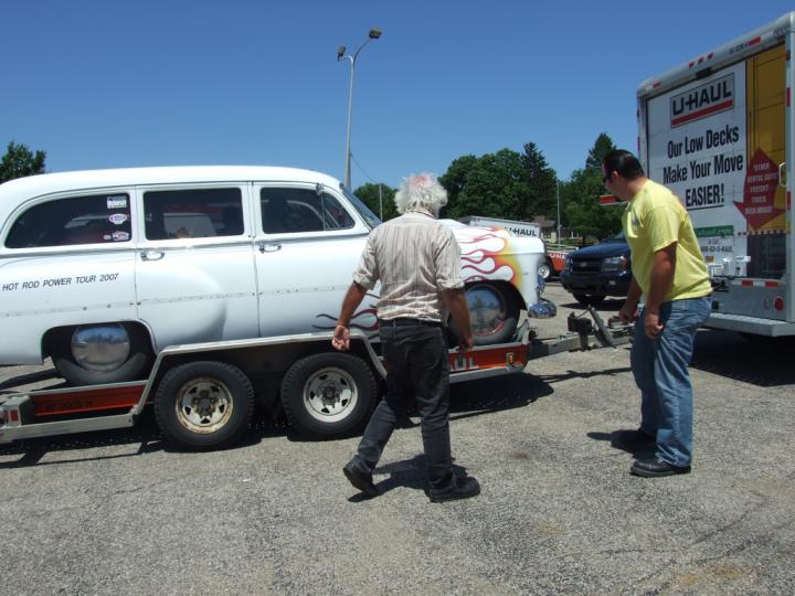

                    • 173rdherd
                      • 2211
ID:	861517yes and I was 40mi outside Madison Wisconsin on the final leg in horrific traffic with no torque-tube rear parts available.

                        that would suck!
