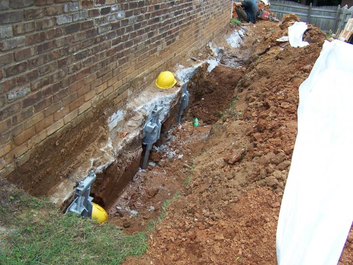

    During last week, we hired out a major job at Weeville.
    The house was falling in. Ever so slowly, less than a half inch per year, enough to crack the sheetrock and the joints in the inside walls, all getting un-level. The foundation was giving way.
    Unit was paranoid about it, the house is falling in. She worries about everything. She MAKES up things to worry about. I was casual about it, yeah, but it's slow. Finally, I "saw" it, yeah, we have to do something to save this house from the wrath of gravity and soil settlement.
    Called in a crew, they destroyed the side yard and screwed the great big rods, like augers, down to bedrock 14 feet below. We're okay now.

              Good move! even if you're not concerned about the value, that's a heluva good upgrade considering the situation. Looks like an expert fix!
                To quote a friend of mine...."dayum".
                  If you are going to bury construction workers in your yard, don't forget to get rid of their helmets too. All the evidence needs to go, my boy. All the evidence.

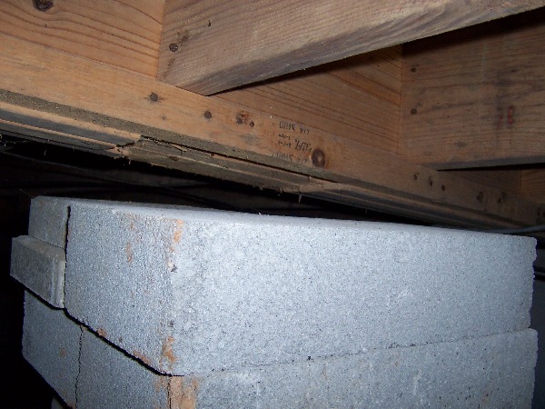

                          Whoever built this house was drunk. They just dry-stacked bricks and cinderblocks under the joists at haphazard locations, just wherever. Most of them just fell over, not holding a thing. They got a good bit of lift from the perimeter rods, and a LOT from the center supports. I had to re-level the pool table when they were done. By a lot. Case in point - one of the useless stacks under the house after the job was done:
                          The house still ain't level, but it ain't going anywhere anymore. Caught it in mid-collapse, sort of.
