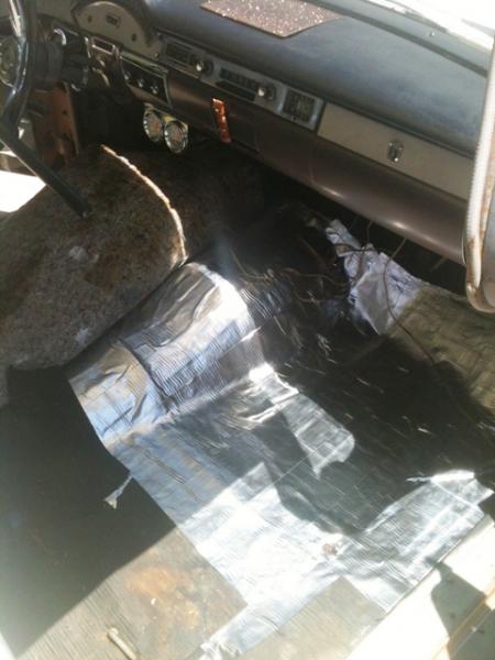

    In an attempt to quiet things down a little in the interior, I spent today laying in some sound deadener/insulation under the rubber mats. I used a material I bought at Lowes called peel and seal. A lot like Dynamat, but way more inexpensive. It comes in a roll and you just cut it and peel off the paper backing and stick it on the floor. It sticks really well. On the test drive, it made quite a difference, the sound level is down and feels overall more solid, plus cuts down on the heat coming from underneath. Like!

      Let us know how well this works. I need to do this for heat mostly on my Impala.

        I went the same route with the sound deadener / insulation and was very happy with the results. Love the wagon too.

          Lowes "peel and seal" -- added that to the master list. Scratching off Dynamat. Thanks for the great tip.

            Peal and Seal - check indeed - perfect timing - this will give the falcon a happier interior - no way I'm paying dynamat prices.
            I looked it up on lowes website and come up with roof sealer that's only 6" wide roll - is that the stuff?
            I thought Randal and others had talked about using the bubble insulation stuff - like this:

              Yes, it's a 6 inch wide roll and 25 feet long I believe. It's about 16-17 bucks a roll. I used 3 rolls to do my floor front and back. I'm sure you would get an even better result if you put in 2 layers. I haven't used Dynamat before so I can't say how it compares, but I think it's a pretty nice budget alternative.

                The stuff I used was foil backed foam with adhesive that came in a 12" x 15' roll. I found it at Menards and Home Depot, both places were $16-$17.

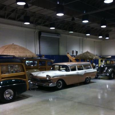

                  The 57 is now in place at the GNRS at the Fairgrounds. Building 9 is dedicated to a special display of woodies & wagons, beach type vehicles. I'll post a few more photos during the weekend.
