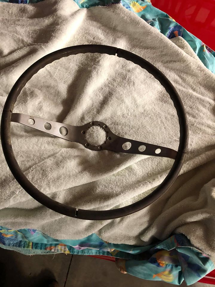

ID:	1255102I need help guy's. I started on this wheel out of a 68 C 10 Chevy truck. I cut it down from 16" to 14". Welded it all back up and have come to a stand still. I need to figure out how to make the handle in the spots where I had to cut it out to weld it.
    Can anyone give directions on what to do for these area's. I'm thinking some kind of plaster mold on the good area and transferring it to the cutouts and fill with resign. But I'm just not sure on what to do. Any idea's suggestions. I can get the area filled with putty but I want the finger grips in it. That is my problem.

    I almost finished the camaro SS wheel for the 67, used the 3M flexible panel repair, must have put 200.00 into it. Got it decent looking, put the interior in and it was on our thighs. The choice was a little rally wheel or tilt column but after all that money went into it we just got a 25.00 vintage wheel. They have a couple foams now that might be quicker and cheaper, problem being they are all in these two tube kits where you need to buy their 60.00 caulk gun to squeeze them out right.
      • 19334
      looks difficult. Epoxy works for filling in cracks, but for making whole new sections, it would be difficult to mold or carve it to the correct shape.
      A unique and proven process for steering wheel restoration. Pricing information
      will tell you what it's worth to do this work, in case you hadn't seen it before.

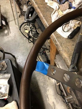

          I bought some PC-7 today and going to try it. Will see how it does on the smaller section that needs a fix to test.
          PC-7 EPOXY PASTE
          • Heavy Duty Non-Drip Past
          • Bonds most everything to anything
          • Money-Back Guarantee
          • e
          AUTO-Seal - Gas tank, radiator and oil pan leaks. Bond: rear-view mirror brackets and mouldings. Fill: Holes, cracks and dents (metal or fiberglass). Rebuild: Steering wheels, etc.
          CONTRACTOR - Bond: Re-bar, firring strips, anchors, brackets, plates, studs, thresholds to masonry. Patch holes and cracks. Repair cemetery headstones. Attach junction, switch, and fuse boxes and baseboard heating panels to wall.
          HOME AND RANCH - Seal: Plumbing, fuel tanks, cellar cracks, and swimming pool leaks, etc. Repair: Equipment, machinery, furniture, and tools. Bond loose tile, ceramic fixtures, and flagstone.
          RECREATION - Repair boats, R.V.'s, sporting goods and toys.
          SHELF LIFE - Well in excess of two years.

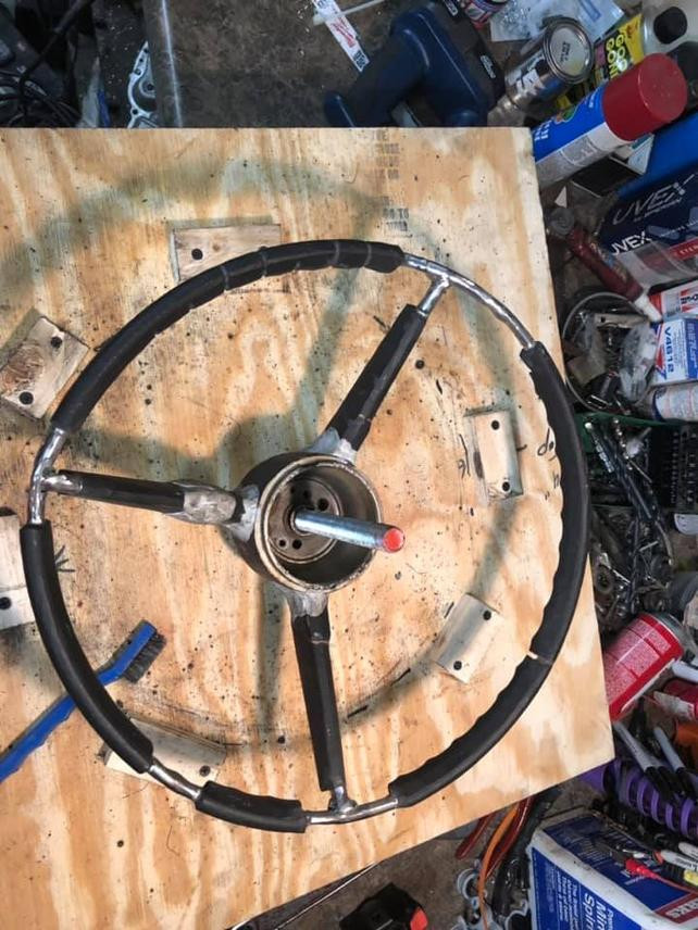

                  One day I will get back to this wheel. It's been put on the back shelf for now. I did finish another 2 spoke though!
