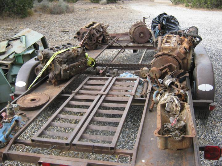

    Looking for some sage advice. Ive got a Flat head ford V8 that has been sitting for a long while (indoors), but was supposedly rebuilt sometime before it was side lined. Its complete with starter, carb, dist and generator. I dont have a radiator or an engine test stand for it. Im not even sure if its a 6 volt or 12 volt (does it matter?). Id like to see if it really does run. Im hoping I dont need to disassemble it. The oil looks good. I will change it though. Any one with experience starting these things up "in place" after a long rest? I had to take it off my trailer and stick it under the car port, so I need to do something with it soon...

      Take the heads off. Flatties are known for rattling until there are holes in the pistons. Also, the blocks are almost always cracked between the cylinder and the valves.

        Sounds like good advice. I found 6 of these things, 3 with cracks between intake and cylinder bore in at least one cylinder, the Merc with a big picture window in the side of no1 cylinder, and this one. The guy I got em from didnt pull this one apart like the others and stored it in his garage (as opposed to the desert sand like the others) He was going to put the Merc crank in it. I was hoping to fire it up and then get rid of it . A friend wants it, but not if its a boat anchor. I dont want to invest anything into this though...(like a head gasket set)

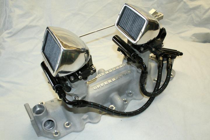

                    EFIing a flat head is sort of anachronistic and with the great port designs of the FH its a bit of a challenge to get it running right. We ended up with IAC on each throttle body (2) or on the ends (3) and had a lot of rain out in the block/manifold at low rpm giving it a bad idle and a fat off-the-line. We added some additional atomization features to the risers below the injectors and it solved the problem. The TBs are 52mm mono blades. 2= a whopping 720 CFM (kinda big). Its not MPI though as I was looking for bolt on solution to Strombergs, so its more a "below the plate" TBI with dual injectors for each riser. I need to try some more ideas out, hence my flat head Qs,. Dennis O at Painless drives the first "prototype" 2 pot system we made for the Truckster (Power tour 2010 and from then on) and doesnt want us fooling with it (read screwing it up).

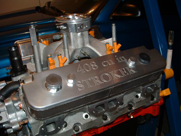

                        I think we are going to get back into the valve cover biz (leaves the flat heads out though...)
                        We used to mfg. a set I designed for the Magnum Mopar V8s (pic attached) but they were kinda costly. Sometimes youve got to pare back a bit.

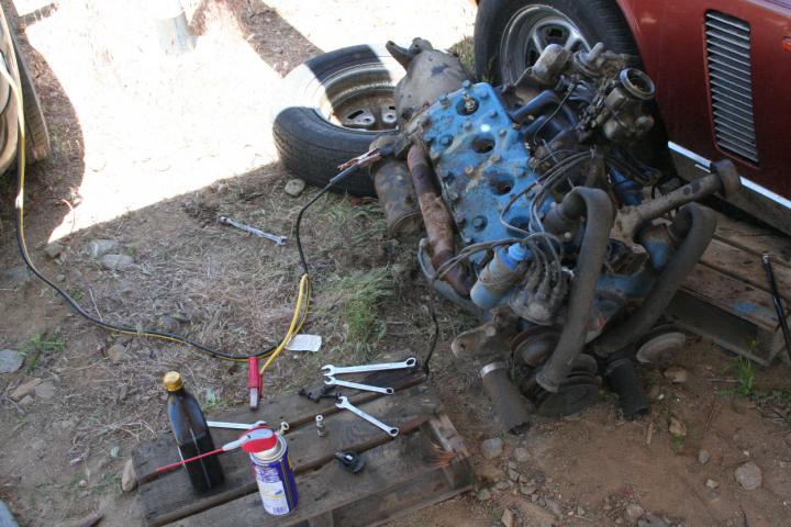

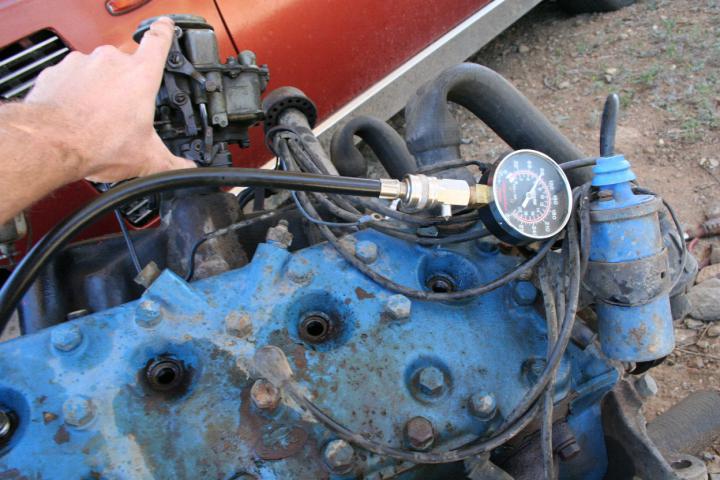

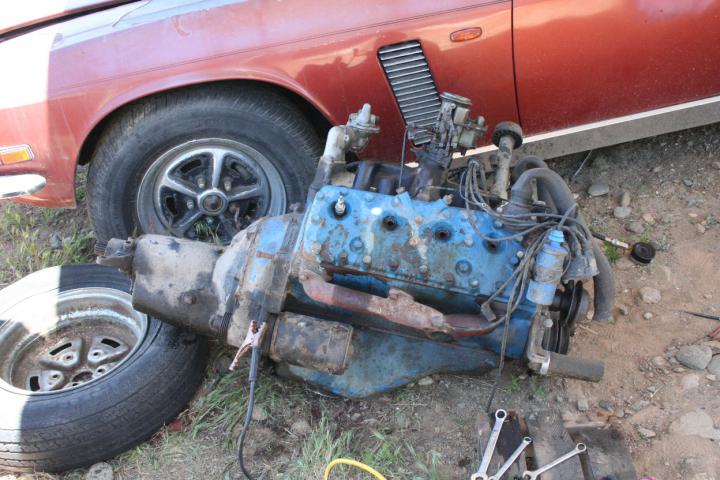

                          Following advice, I pulled the sparkplugs and tried to turn it over. This is when you find out how sharp the timing indicator is...It turned over by hand with very little torque after I de-pinched my hand. Squirted some ATF in each hole and went back to work. came back out and jumped the starter 1 to see if the starter worked, 2 to turn over the motor.
                          The starter spun nicely! The motor spun smoothly and silently. The compression gage was applied to each cylinder with the carb WOT. 6 of the cylinders read 90psi. 2 of them varied between 30 and 80 psi. Im thinking stuck valves. With the uncertain compression test results Ive decided to pull the heads and check things out...

                            Is that flathead lying on a Jensen Interceptor?
                            • BKBridges
                              • 918
                              The Rostyle wheels on the early Interceptors make a great torque management system for Flat head V8s...
