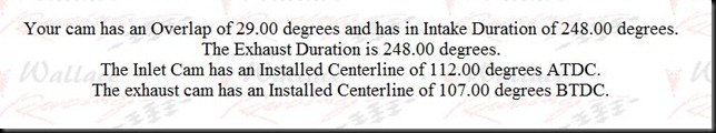

    I am deciphering something simple...but don't know how.
    this is my cam. it is a simple cam, around .4 lift..very full fat profile.(injection)

    10/54 49/15

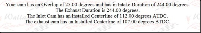

    a guessing game on where the duraton is coming from.. I simply added 2 degrees to everything
    12/56 51/17
    this is where I stopped. with a height of 1.56 inches, and a rocker ratio...just how long is two degrees, and why would lift start sooner and close later?
    the lifters the cam came from were very very squishy, I mean absurd.. almost .25 inch squashy. the car was crazy with them. having solid lifters has made alot of noise when it has to..but am wondering how to decipher the gain in lifter, and duration together..just by being solid for the whole cam profile.
    I learned generalizing..
    beyond 260 gets rough. this would need more than 5 degrees gained in duration.
    can lifters be that bad?
