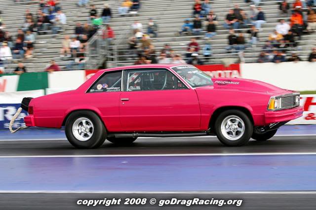

                      I agree with Jeff. TRZ is THE ticket for this combination. If you don't want to listen to Jeff, then talk to this guy, Paul Ferrucci.
                      He's making just north of 1100hp with his Malibu and drives it on the street regularly... with a whole host of TRZ components. Between the guys at Scrivner Performance and TRZ, this they made this stock suspension Malibu one of the baddest G-bodies on the planet.
