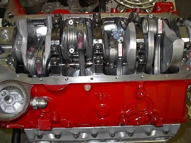

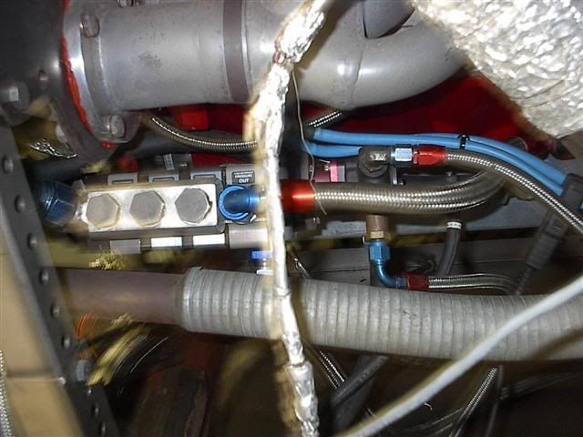

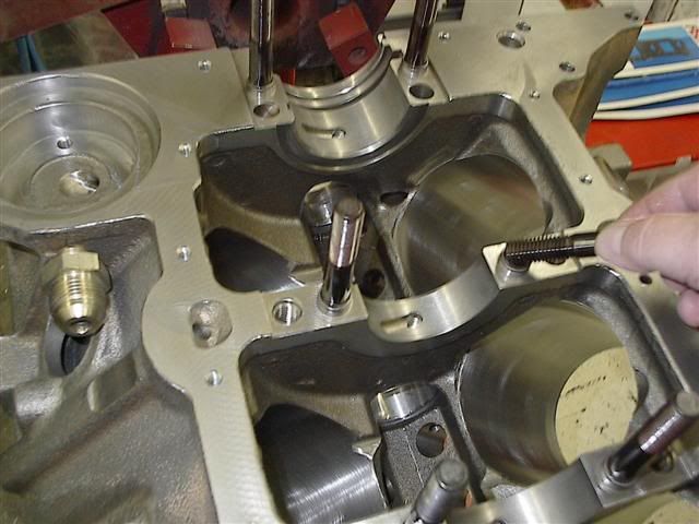

          I run a -12 x 3/8 fitting in a lot of my endurance engines. No problems at all.
          Here are a couple shots of how I've done some on small blocks, the first one is before the fitting get drilled out to 9/16
          And a crummy shot of the line going from the pump to the fitting
