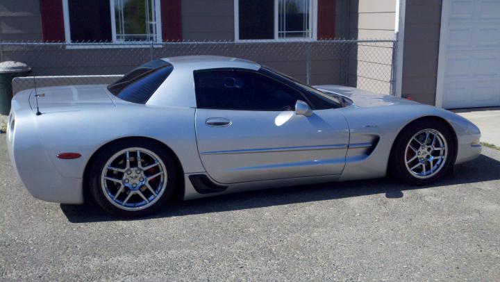

    I just ended up with a wicked Quicksilver ZO6 Vette....lowered....chromed wheels.....some gonzo expensive tires....full Borla stainless exhaust front to back(headers too!)...not sure if there are even mufflers on it as you can hear me rowing gears almost 1.5 miles away. Dyno sheet says 527 hp at the rear wheels....has an ungodly cam....huge mass air....wicked sticky clutch....this thing will break em lose at 50 mph easily.....AWESOME ROCKET......but when I took it to the Calif smog man he laughed for 10 minutes straight....No cats....no air pump...MISSING.....failed OBD self tests(WTF is that?)...smog results look like this
    15 mph test.... HC 55 max....meas 264 ....CO% .5 max.... .94 meas
    25 mph test ... HC 39 max ....meas 93 .....CO% .48 max .... .90 meas
    Anyone want to trade for stock Calif approved crap?.......

                        You're going to need to have every aftermarket part have a CARB E.O. # on it. Otherwise, swap for a CARB approved part or the stock part. I'd guess that "ungodly" cam will be difficult if not impossible to tune around to get it to pass smog.
                        It would be cheaper and a lot less headache to offer him $500 cash. You'll still have to deal with a LEO checking for CARB E.O. #'s if you get pulled over.

                          Ya....thats the direction I'm heading in..... I got the car for a song.... Even if I have to pull and redo the motor.....buy all the OEM stuff..... I'm STILL way ahead on the value of the car.
                          Option 2 is to part it out and put it all in a 69 Camaro I just picked up.
