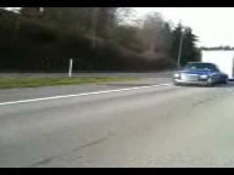

and you thought you were having a bad day ?

    Prime example of why the tow vehicle needs to weigh more than the load?
        Exactly. Maybe shouldn't have been going so fast also.

          The high center of gravity didn't help much either.

              A very high center of gravity, no trailer brakes, and too small towing vehicle did that. The Uhaul trailer I pulled my GTO from Charleston SC to where I live now was too high, but it had brakes and I was pulling it with a truck that weighed 15k. Going down hills it would sway around like that, so I would ride the brakes and hold the gas to the floor so the truck wouldnt slow down as much as the trailer. It seems people dont think about how high is too high when they build a trailer. The freakin rocker panels on the trailered car are higher than the window sills on the tow vehicle. I have seen better designs built with trailer house axles.

                  not enough tongue weight.

                    If the idiot would have tapped the Brake Actuator early on that would have brought things back under control quickly, that is providing the trailer even had brakes!
                      one more reason I love my trailer, it's heavy huge and ugly -but it won't do that unless I get really really stupid with a load.
                        Negative tongue weight sucks. Or rolls, apparently.

                            And to think I wasn't comfortable towing that much weight with an F150, and stepped up to a Super Duty instead. And he's towing it with a compact car...
