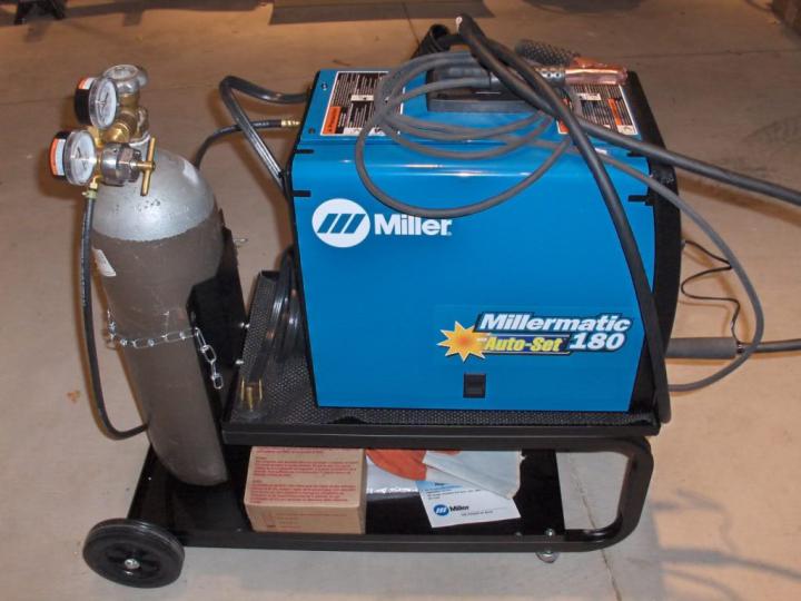

            Here's mine. Seems to be exactly what you're looking for.
              Bob - how much have you used your autoset 180? I'm liking the 211 model of the same line... it's $1000ish.
              There's a hobart187 supposedly still new in the box on craigslist near me for $500.
                I don't remember the model of my Miller right offhand............thinking 208, 210 something like that?
                Its 220v and has the same cart and regulator as Bob's. I've welded everything from 3/8" plate to sheetmetal with it, and while I'm no pro the machine has my friends thinking I am.
                Paid $600-700 about 9 years ago, bought new from our local welding supplier during their annual openhouse/customer appreciation sale. They do a big demo day and have snack goodies, and mine was no special deal, just regular advertisement on their flyer.
                        In all reality I haven't used it all that much but when I did, it worked great. I think I spent about $1000 for the whole deal, welder, cart filled bottle.
