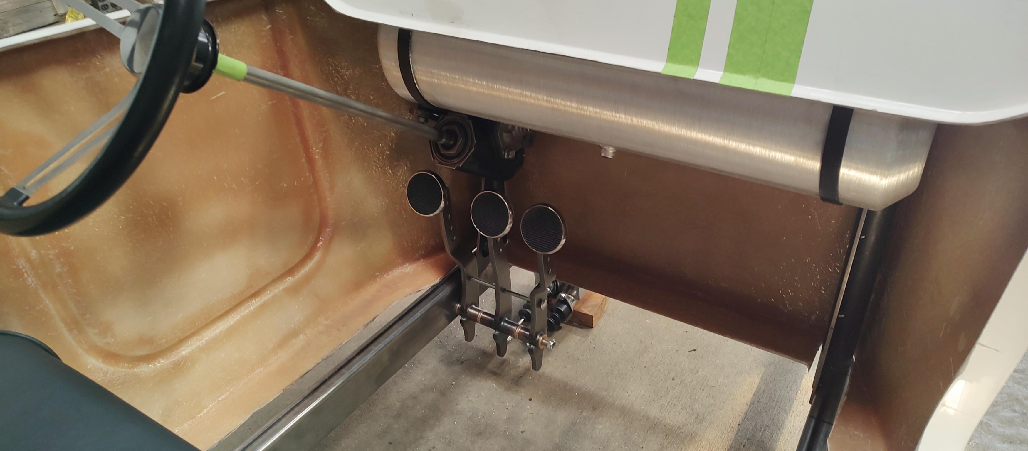

      When I first looked at this picture......
      My Brain automatically thought,
      My God, he is going to retro the
      Original Three Pedal planetary Transmission!!
      Click image for larger version  Name:	IMG-20250219-140105859-2.jpg Views:	0 Size:	331.1 KB ID:	1366022
      Double Clutch ?!
      You CAN'T FOOL ME !!
      One of "Dem Pedals is the Brake"
