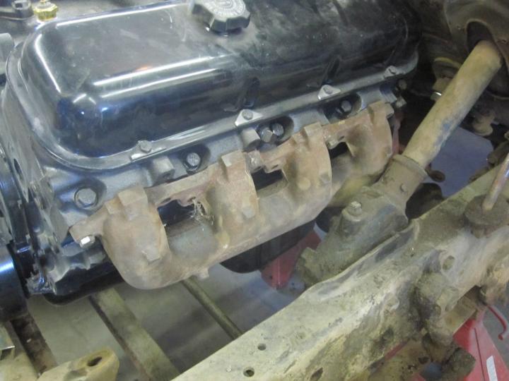

          on this one I just broke off the gasket lip on the inside of the car, then pushed the windshield out. If the gasket is still flexible, you can just push the glass out, but you have to pull the lip away from the metal on the inside as you go.
          More progress...glass in, motor in, exhaust manifold ground to fit, ready to make some front mounts. The stock small block bellhousing mounts make this kind of easy.

                  We'll see about that....but I am getting stuff done. The mounts look easy, the small block mounts installed in the 6 cyl holes end up lining up almost perfect with the front of the big block, I just need to make some 1/4" thick adapter plates.
                  Still need to tear apart the fenders and grille and stuff and do all that bodywork....I'm almost getting tired after 4 or 5 days of working on it 10-12 hours

                        Engine mounts are done, it's level and centered and almost has clearance around it...might need to find some other valve covers with angled ends. The spindly little front mounts just carry some weight, they don't locate the engine. The two big mounts under the bellhousing do all the locating. If it works on a 235 or a 283, it's gotta work on a big block, right? although there might be a bit more torque coming out of this mill.
                        The mount adapters are 1/2" 6061 that I had left over from building the underwater robot.
