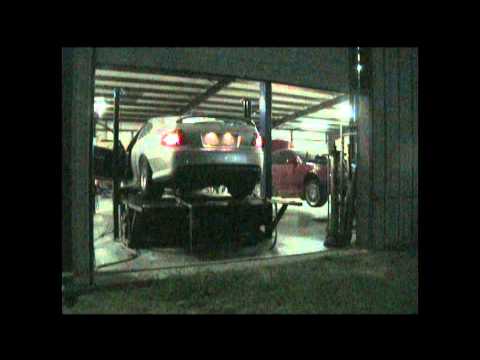

                      Bend over, touch your toes, me n Ethyl will show ya where the wild weasel goes. Shaping up to be an interesting dyno day on the 29th at SNL in Haslett, providing we don't barbeque Phoenix on the dyno tuning it.

                              No sir, SNL Performance in Haslett Texas. Builder is private-me. No sponsors though I wil admit to an occasional negotiated discount.
                              Damned injectors were so big we had to take the bl;ower off to get them on. Everything is on and buttoned up, waiting for Matt to tune it. E85 conversion complete except the tuning.
