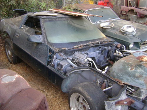

            You can't have mine, but here's an example of something that was purchased a while back for a grand: You might do better yet with some shopping.
            As you would have been finding out had you tried, there's nothing in the stock frame (made from sheet metal and integrated with the body pretty-much) that you can use. Suspension components etc. need to be just pulled out and bracketed into your stock frame (or maybe something fabricated?). Even the more conventional perimeter frame from a 2nd- or 3rd-gen still wouldn't have worked due to shape, etc.
            Misc. issues you are going to run into will include the fact nearly all rear diffs from the relatively light and low-powered 4th-gens are Dana 35's...there are a few 44's out there but hard to get...and I don't know what "kits" do about the steering rack position. It's pretty common that guys go to use Vette stuff in other cars and don't worry about the rack until they actually confront the fact that with normal engine positioning that rack and the front lower portion of the engine both want to go in the same space (the Vette has a lot of engine setback and mounts the rack high and in front of it). That's a killer. Presumably any kit will have this figured out. possibly by lowering the rack (along with tie rod ends out at the spindle) so it will go under the damper.
            If it were me I'd also consider stepping back to easier upgrades such as disc and rack conversions and narrowed 9" etc. on that pretty Chev which looks in good condition now, or go full-bore forward into an Art Morrison-style fabricated frame which would be a lot of bucks and time but really push your hobby level forward.
