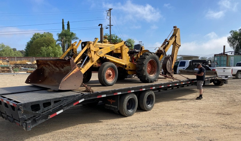

                I once borrowed a trailer w/ 3500# axles to haul a forklift, fortunately I was only going across town, the axles and tires looked stressed to the max and the forklift tire broke through the wood deck. Those suckers are heavy. I was lucky 'way back when I first bought a partially-completed car-hauler-trailer, the seller was touting the 5,000# six-lug axles which I was OK with because bigger is better even though I didn't think I needed them, but in the time since, I've loaded that thing up pretty well. Last was 4 tons of steel beams for a 300 mile drive, there the 20' length beams became a polar-moment-of-inertia deal which is much of the reason my next trailer (sitting uncompleted, I-guess waiting for when I really need it) is a 5th wheel (w/ 3 six-lug axles). I would really like to go my whole life without ever once having a jack-knife accident.
                Happily a buddy got a deal on a 40' gooseneck tandem/dually and was there to help when I needed a ride for this old Case backhoe I bought last year. It will be my hope that my own trailer will haul it OK, I believe the tractor is under 10K.
                Friggin' Case, the "rebuilt" injection pump performed flawlessly long enough for the demo and to get it off the trailer and is now kaput. Add project # 150 to the list.
