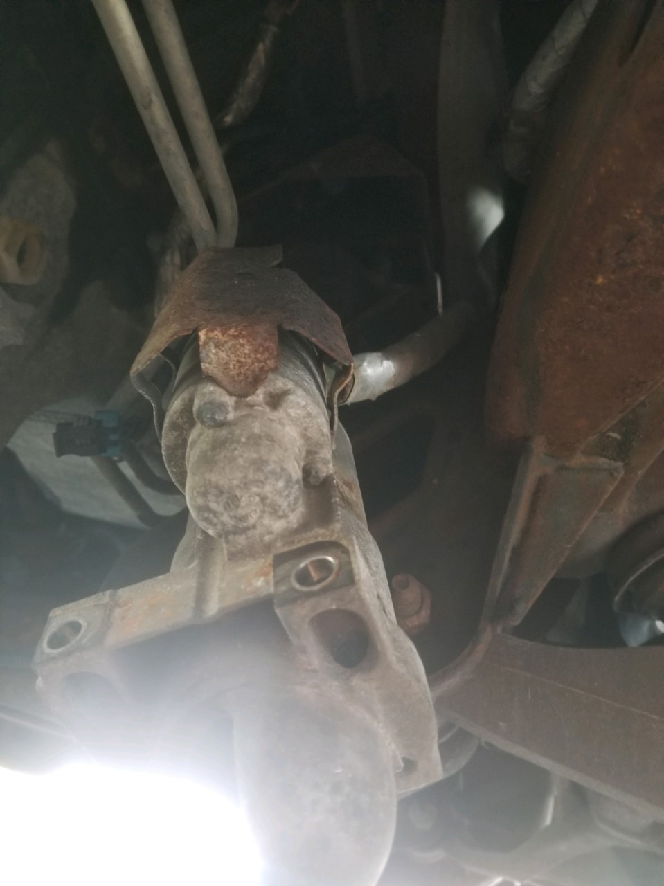

    Remove the starter. There are only two bolts and you can leave the wires connected if you are careful. Slide it forwards and then down between the block and the transmission cooler lines. The Crankshaft position sensor is hidden behind the starter, no way you can access it with the starter installed.

    Starter hanging

    Pop the starter back in and give it a shot. My 2006 Chevy Express 6.0 LQ4 has not given a P0300 since I did this. Its cheap to do and only took me an hour.
