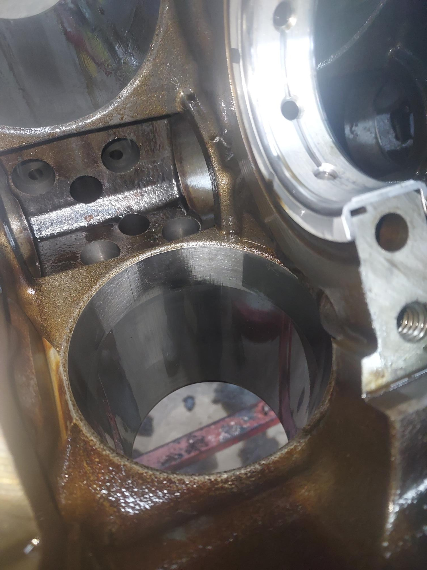

    So we had a oil pressure issue with our first LS build, decided to build the stroker to learn a little before winter sets in. Started with a clean looking motor, cylinders cleaned up with a ball hone. New rings, new main and rod bearings, cam spun really nicely, most likely should have changed the cam bearings, but live and learn. Anyway, disassembly just looks like graphite lapping compound everywhere. All the coating on the skirts of the pistons is worn off, cam bearings are too soft, scratching easily, but only measuring ..0011 bigger than the new ones. Pushing brushes thru the galleys is not bringing any clogs or sludge. Looks almost like the ARP bolt torquing goo is all over the motor, but this sludge looks metallic. Bearings are scored and just a discoloration in a lot of places. The cylinders look like pistons with skirts were being run, black with shiny areas everywhere, definitely feeling a ridge between black and shiny. I can see it as maybe the babbit from a GM cam bearing since something definitely happened, just seems extreme for a motor that ran for 5 months or so.

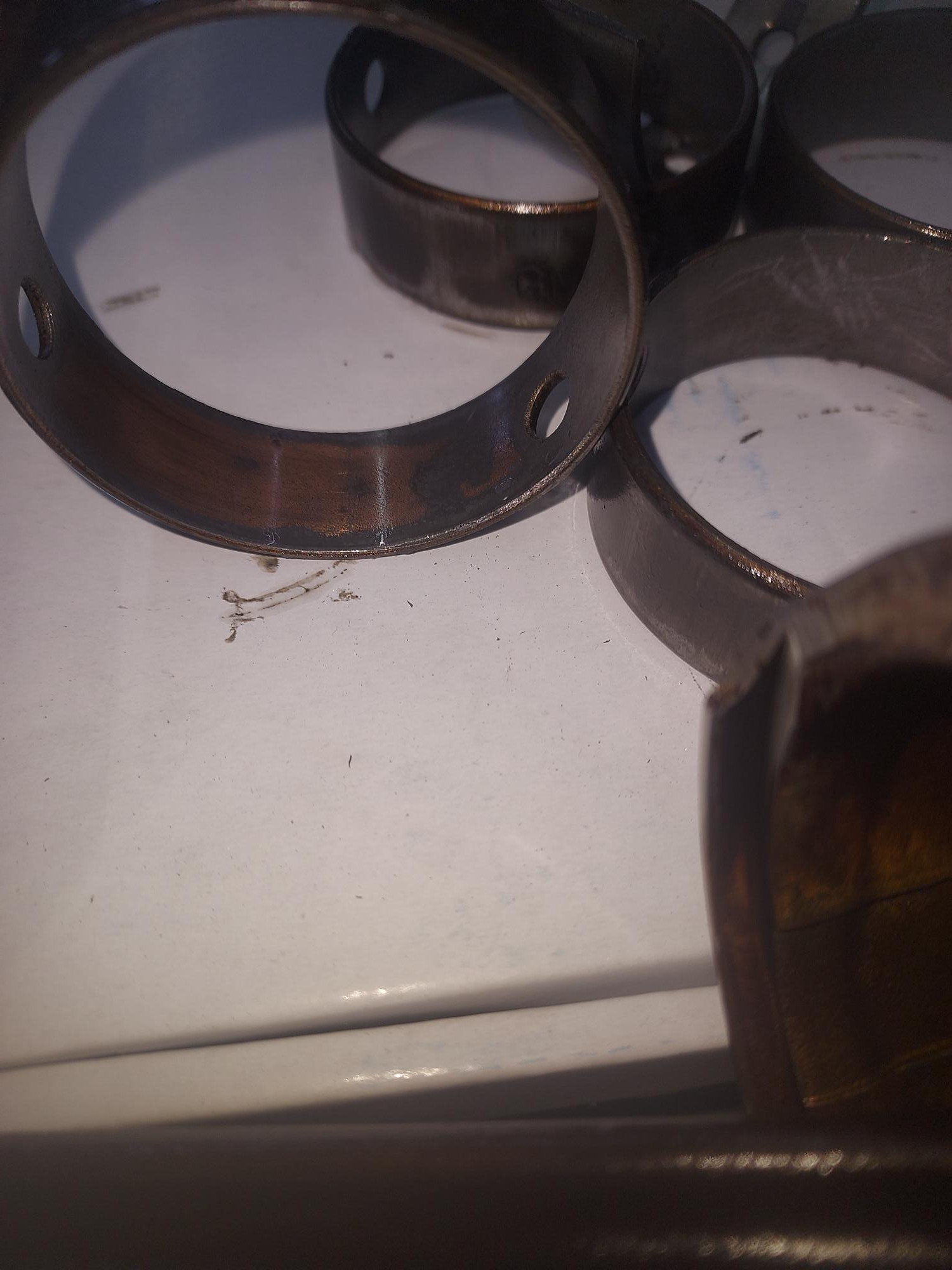

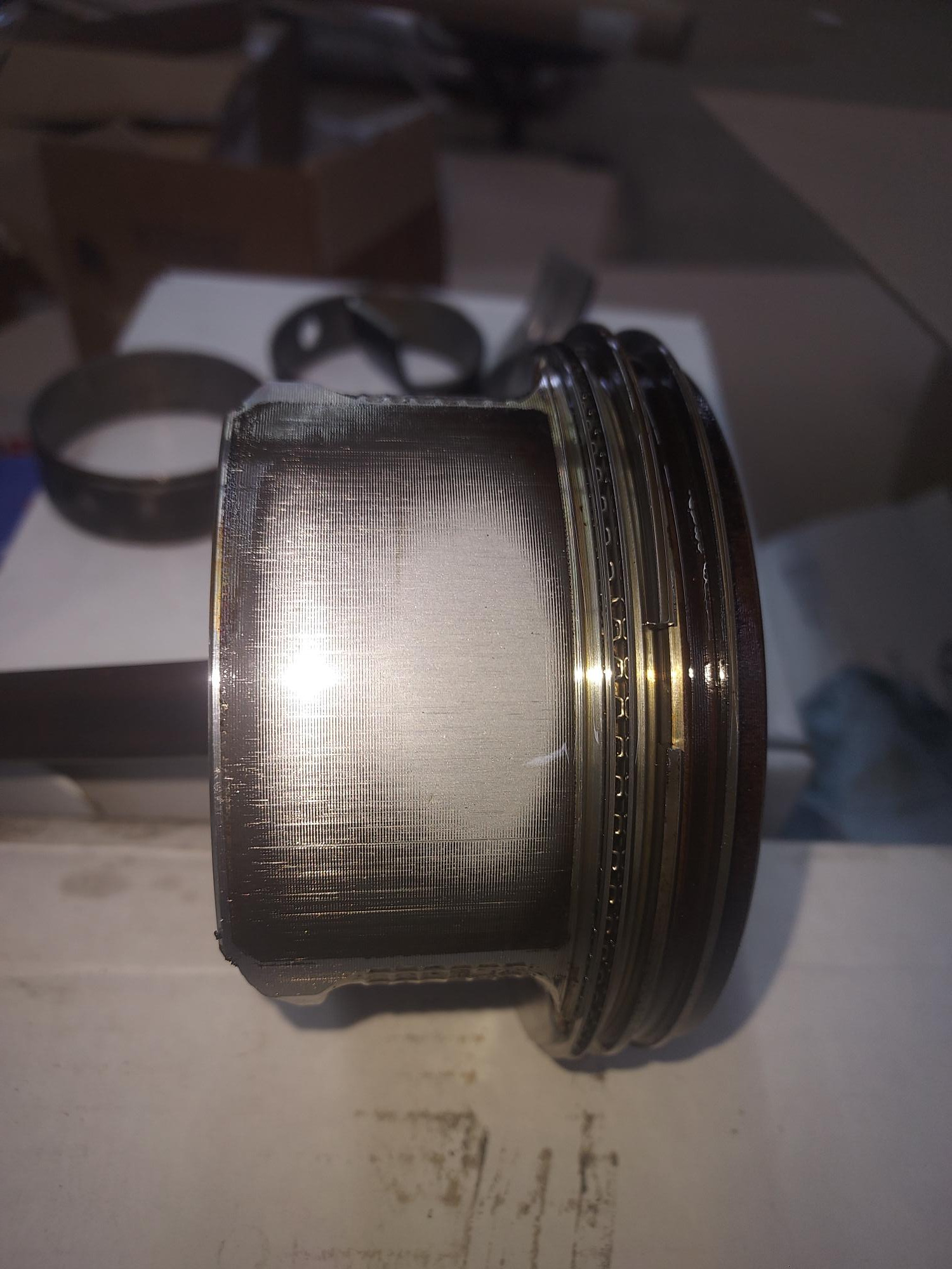

        Apologies for mess of pictures again.Cam bearing were not changed, discoloration in the pattern in the cylinders and lapped piston skirts is why I call this lapping compound. Click image for larger version

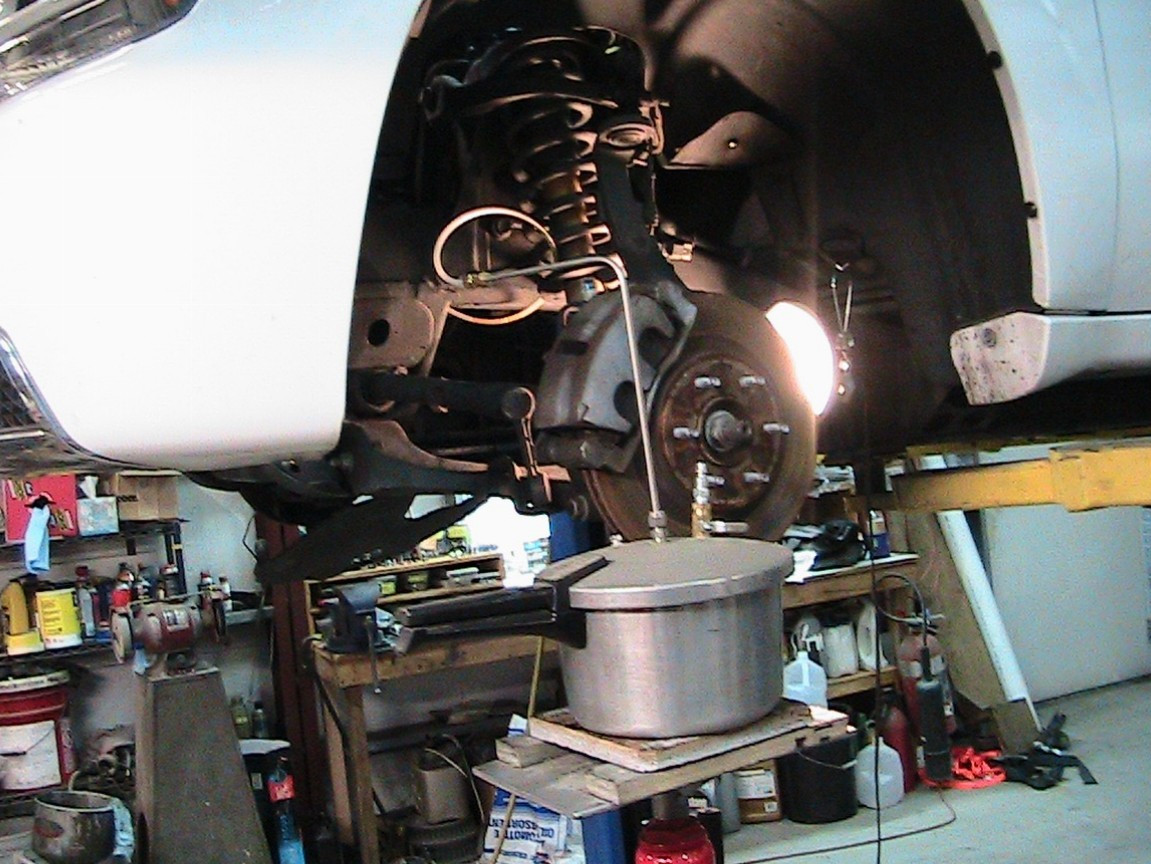

          I was just bolting in the "correct" engine into a Trailblazer SS that belonged to one of my Grandsons. What we (the rep from LKQ and I) worked out is that the internal oil pump can't pick up oil like a distributor-driven pump and, of course, there's no way to spin it up before engine start like with a small block Ford or others. Evidently, they also don't "hold" a prime after sitting for long periods like a salvage engine would. I built a pressure luber from a pressure cooker and there are online plans for building one from PVC pipe. Looking for a pic......
          Nope - can't find a pic. But there's a plug on the driver's side front roughly under the front spark plug but in the block. It goes immediately into the oil galley. I went to our local Parker Hannifin dealer and we came up with a fitting that screwed into that port and was tapped for a 1/4 NPT and I built the system from there. Air pressure over the oil works great but just make sure you don't run out of oil in the pressure pot or you have to start all over.
              Here's the Trailblazer SS thread Dan's talking about..
              Well, it's now here from JAX, FL - just pulled into the driveway a couple of hours ago. We drove it on the trailer and it had an excellent set of castanets banging
              Here's the pressure pot he built...
              Pic:

                    I made an external oiler out of a cheap SBC pump mounted in a 2gal bucket. I just tapped the oil pump outlet for a hose (AN in my case since the oil feed on my V6 is AN) and drilled a drain pan bolt for a return. The hose on the pickup is so it reaches the bottom of the bucket. Had to throw it away during a move since the carrier wouldn't ship it for whatever reason.

                      401 still has clear oil that you cannot even see on the dipstick, so it will stay in a while longer. DanStokes I still am not sure if you just got a questionable engine or if you did a rebuild before you installed. It sure seems like the chances you take. We pulled the pan and as soon as the thrust bearing cap came out we knew this motor was not going to last long. Also curious about the question whether you do that process with each oil change.

                          I have a fuel injection cleaner cylinder from OTC 7448 that I used to pressurize my big block just to make sure I did not miss any plugs, so I am pretty sure that would do it. Pulled the 401 apart after about 14o miles.. Same signs of glazing starting, scratching and wear from the piston skirts. But trying to think about combustion physics with these direct injection pistons and skirts running .625 out the bottom of the cylinders,there are far too many things to blame. So far I have seen things like staying away from synthetics for the first oil, but the third engine builder I really trust says it looks like there was not enough piston to wall clearance from the machine shop that machined these bores to exactly 4.065 when we supplied the piston. But LT heads have valves swapped positions and is u channel reverse dome for the direct injection made me wonder about combustion physics. Either way, different wear pattern that still ate .002 along the top 12 and 6 skirt sides of the cylinder. WE had windage tray interference causing harmonics and the number 2 bottom rod bearing fell out of the rod, seemed like it was about to spin.
                          So it seems like there are plenty of other break in things I did wrong other than the no priming deal that I am accepting. So now its making these two blocks round again, getting LS pistons for the 401, or finding a 6.2 and leaving it the hell alone. I still cannot see buying a used motor without at lease checking mains or rings, but without figuring out if its just the oil or a combination of synthetic oil not allowing the rings to seat and instead wearing down the skirt sides, I cant figure another way. I hate that now it feels like a cop out to buying some 140-180K motor and not even checking the bearings.
                          Either way, we used the Total seal piston ring blue lubricant in the 6.0 that did not seat properly, used permatex assembly lube and clevite bearing lube on the 401, Pretty sure no matter what we use will be washed away with the pressure of oil priming anyway, so maybe just go straight 30 break in oil next time. My head has been spinning with these performance rods being 6.125 long like its some kind of upgrade from 6.098 if we rebuild the 401, seeing if I can keep the cylinders round with my Lisle 15000, set up on my milling machine. Might as well start off with one foot in the grave.
