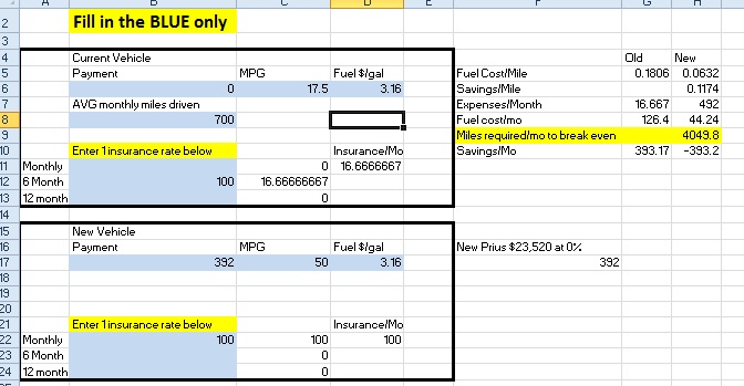

                        I agree that tuning should be your first step and should help. I couldn't figure out how to upload an excel file so I did a screen shot. You can make one like this to compare the new/used vehicle or current vehicle with upgrades to see which is most cost effective. This is comparing my 59 Chevy PU with a Holley, phase II Bowtie headed 350 with a 5 speed vs the P word.
                        Kevin
                        • Huskinhano
                          • 5456
