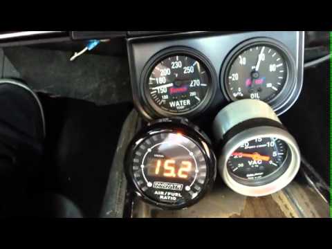

    I recently bought an Innovate MTX-L AFR gauge in preparation for a future MegaSquirt installation.
    Today I was able to hook it up into my '73 Dodge Dart and check it's readings at various rpms and engine-loads.
    Now remember, this car runs on propane, so a "15.5:1" A/F ratio is supposed to be the 'stoichiometric' ratio here.
    Some interesting stuff surfaced (for me):
    Idling: 14.5 - 15.5
    No-load high rpm: 14.5 - 15.5
    Throttle release from high rpm: upto 22+
    During driving I noticed the following:
    Steady speed: 14.8 - 15.0
    Steady speed, with very little extra throttle: 14.0 - 14.5
    Normal acceleration: 16.0
    Firm acceleration: 17.0
    When I squeeze the PCV-line to the carb closed, the AFR drops to 13.0.
    I've also shot some video of the motor running with the car standing still in Neutral (around the 2:00 mark I put the car in Drive)

      Your accelerations look a bit lean, but otherwise everything else looks good. With out knowing the true properties of propane, I'd "expect" the acceleration numbers to be a few points below 15.
        The basic ratio's are pretty much the same for regular fuel; Rich at idle and acceleration, Lean at cruise.
