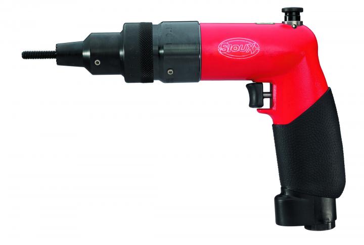

              These things are bad ass. We use one for installing clinch nuts in steel cabinets we build and sell. They can whip out a crapload of work in a very short time.
              Click the link above. We purchased our Sioux clinch nut tool from a company named Deco, but I am sure they are available through other distributors.
                [ATTACH=CONFIG]27939[/ATTACH]
                those are awesome - but at nearly $600.00, ummm
                • Ron Ward
                  • 5340
                  Yeah... kinda steep, unless you are going to install 5-600 clinch nuts per day.
