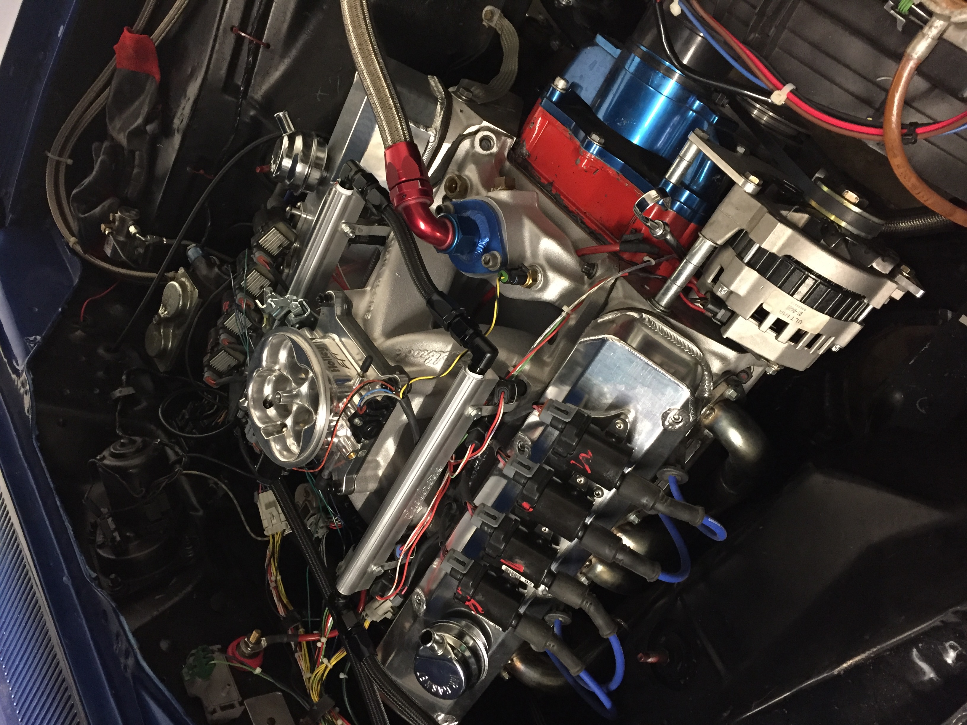

          Easy enough on an LA motor . That bad coil deal on drag week really scared me, now I have 8 of them. I should be able to lose 1/2 of them and still drive lol. Click image for larger version

              I ran the COP last year on drag week with a carb, I just put the first 80 or so miles on the full EFI this last weekend. So far so good, I need to work on a few things(accel enrichment and closed loop idle) but its doing great so far.

                  Mike I bought those coils at a salvage yard $40. They are the GM truck coils which are some of the hottest factory coils out there. I bought a mount for them and bolted them to the valve cover, but you can whip up something for that I am sure.
                  For the crank trigger I used an MSD bracket and bought a blank sensor mount. I drilled and tapped that sensor mount for my crank sensor which is a Cherry hell effect sensor. I had a friend of mine cut out a 36-1 trigger wheel.

                      I believe it is 1/8th, its thinner than most I have seen but the price was right haha. I have had it to 7000rpm with no sync loss.
                      I am sure you can use the MSD trigger setup but the resolution of the 36-1 wheel is better.

                          I don't have the ability to do that and have anything decent looking lol. I borrowed my Dads crank trigger stuff to try out and then ordered the pieces I need from MSD. MSD was very reasonable on the individual pieces. I think I spent about $80 on the pieces from MSD you see in the picture. The trigger wheel was a buddy deal and the sensor was $70 with the wiring.
