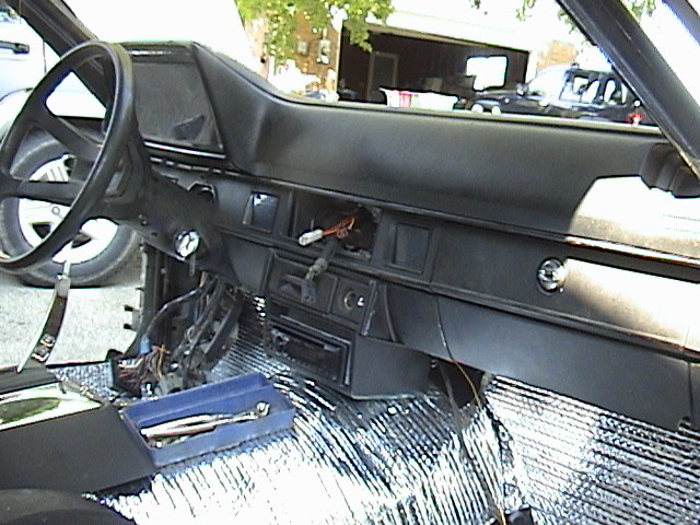

      #47
      Originally posted by greenXpress View Post
      AdvAuto Bob just where did you get that nice shiny stuff. I'm needing some of that in the old truck.
      I sell and install it, but it ain't cheap.. even at cost!

          #49
          This is the product that Dale(Quick52) set me onto... Home Depot... its cheap...
          works pretty good on his 52
