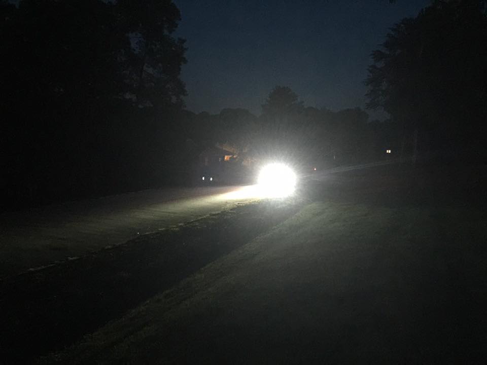

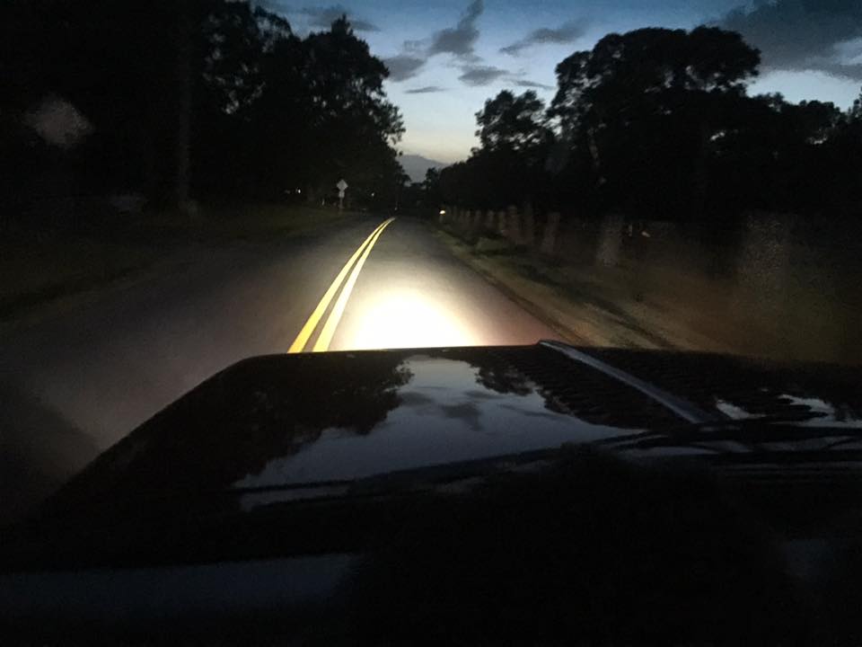

                              I have LED driving lights and white star head lights. I have plenty of light and I have them aimed pretty good. I have never had anyone flash theirs at me driving it. I drive mine a lot at night.
                              This is just the driving lights which I do have the relays installed for all the front lights.
Name:	New LEDs driving lights2.jpg

Name:	New LEDs driving lights7.jpg
                              This is with all four light and the flash of the camera!
