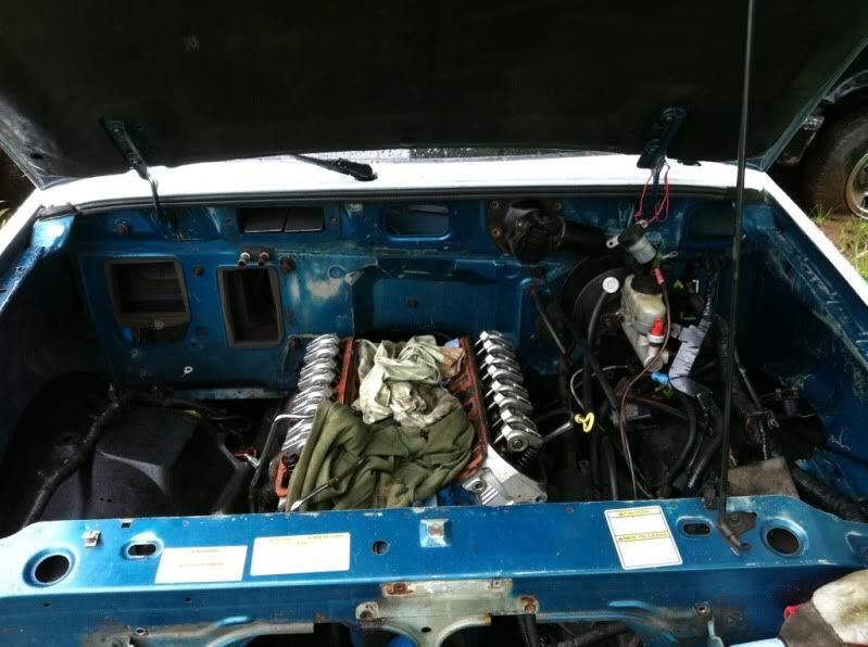

                      Hey, great ideas, thanks! And thanks Dan, I'm in Canada, shipping is just foolish...
                      I bought a couple 1l water bottle, stainless, I believe.
                      Do you think one liter is enough for the overflow, or should I double them up? It's in my Ranger, but the engine is a stockish '92 5.0.
                      Here's a shot as the engine bay is stripped, and almost ready for paint:

                        1ltr should be enough..
