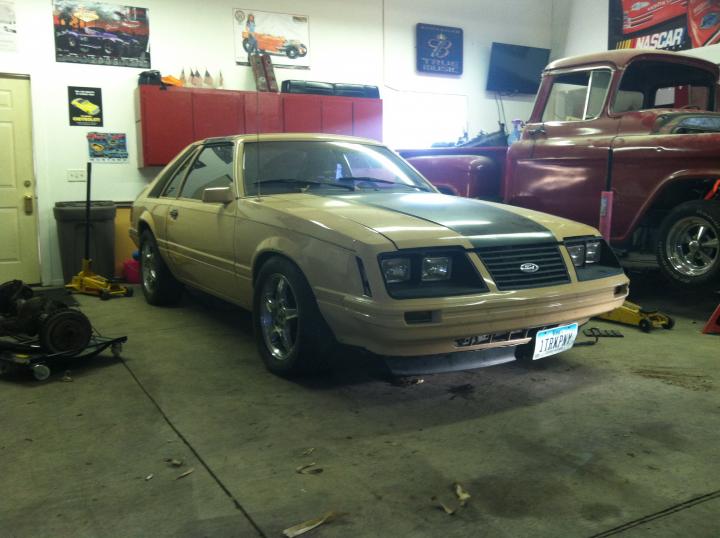

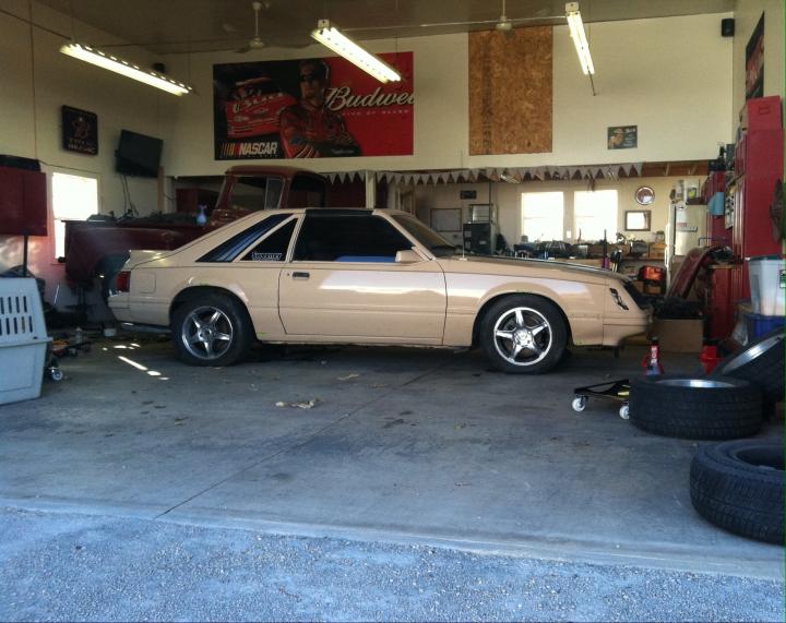

    $0.00 in my 5 lug swap. Need to finish brakes. What do you guys (and gals) think? Click image for larger version

    nice. I still beeline my eyes to 5 or four lug to determine integrity of the mustang builds. I grew up with that in the 80s. They are actually nightmares for a non-welder.. good work, looks nice.

      Bad pictures but it looks good. Gonna put as big a tire I can on back. TallxWide. Also going to powder coat the wheels. Not liking chrome. Anybody know anything about lugnut key locks? The back two tires have 10 locking lug nuts and no key. I have ordered three different sets and no luck.

                  We used the spindles and lower a arm. Now the lower a arm is a bit longer on the sn95 and it puts the wheel out flush with the lip. Not 100% sure it's gonna work yet. We cut a coil out of the old springs and we like where it sits. Might go a size or two smaller up front on tires. Now the back. The rear end is the same 3.08 trac loc as my 84. On 3/4" wider per side and a 8.8. We have all the brake work to so yet. A couple fittings and a little relocation. Also parking brake cable. I believe there is a replacement cable that will work. Also would like to go from 225 to a 245 and go a little taller in the rear.
                  So far I really like it. I don't know if I like the chrome yet. Need to get wheels off the car somehow. Need to figure out why my t5 puked its guts all over the garage too. I hope I can solve those problems and keep going forward. I like how the wheels fill out the wells for only being 16"s.
