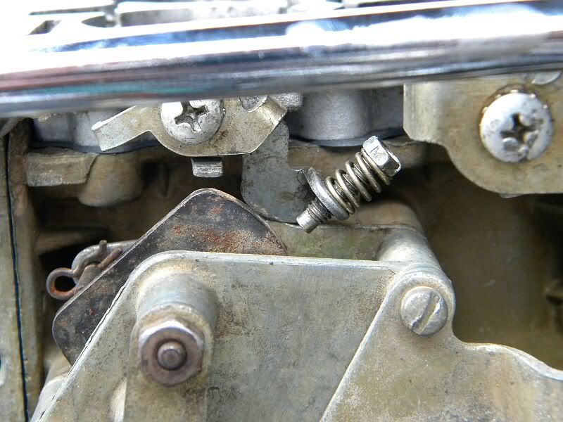

    I ran over to the local speed shop, Westside Performance, to get a new diaphram for the Holley 3310 on the car. It's ancient and I did a spare parts rebuild on the carb back when I put it on years ago. But, the I didn't have a diaphram. I used the old one. It was a bit dried and cracked around the edges, but looked OK. Today, I decided to get a new one just be sure. I ended up getting one with a quick change lid and an assortment of springs that's made by Quik Fuel.

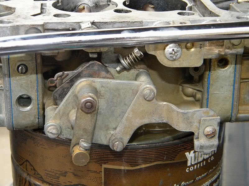

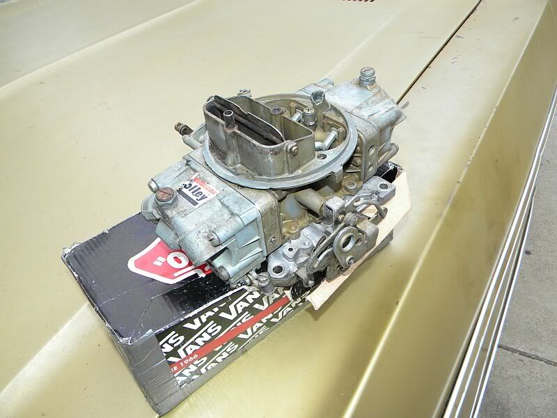

    My other and more nasty job was rebuilding the freebie 750 dp today. It was nasty because I had to get out the ancient 5 gallon can of Chemdip. My sinuses are still closed. I had to break down and buy a kit for this one. It was too far gone. I got it back together, but I ran out of time to test it out.
    Notice that it has progressive linkage. It also has no ported vacuum on the metering block. Not sure what this was used for.
    The car now does burnouts with ease. That locker is sure violent when it hits. I kinda like it. ;D

      NICE!
      Not familiar with that progressive linkage - I bet that was a factory piece of some sort.
      So - with the quick change vac kit - how does the vac carb run?
      I'm generally a fan of vac sec carbs on any street car with an auto trans that's got a reasonable cam. The only reason I'm putting the 600dbl pump on the 302 / auto in the ranger - is cause I had it!

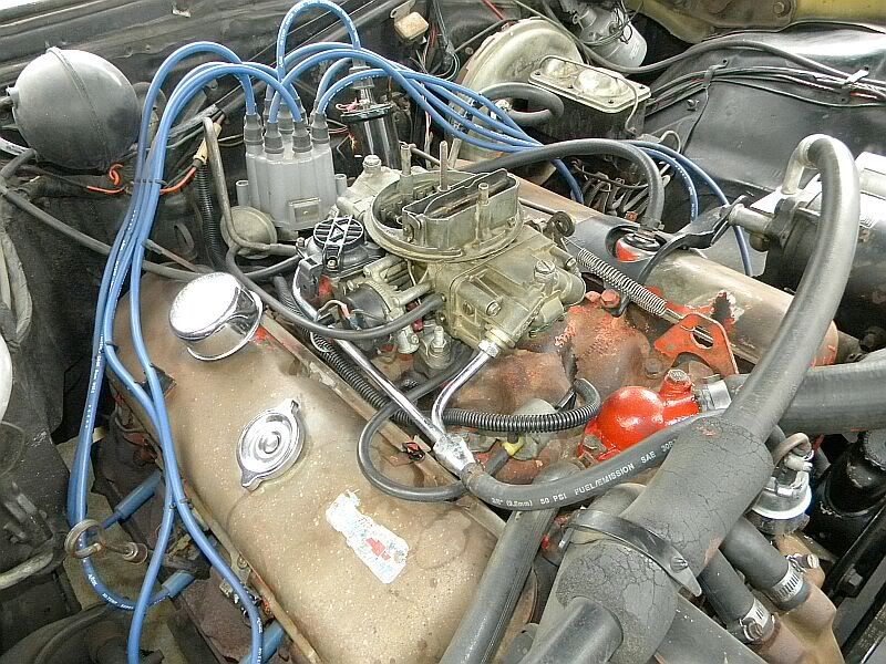

            It's got a Pertronix.
            It runs fine for what the engine is. 130k miles with a flat cam. #1 intake lobe is completely gone and has been since I bought the car. It's shocking how smooth the car idles and runs all on 8 cylinders.

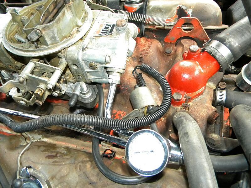

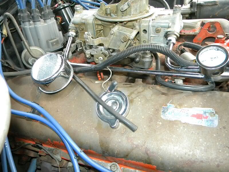

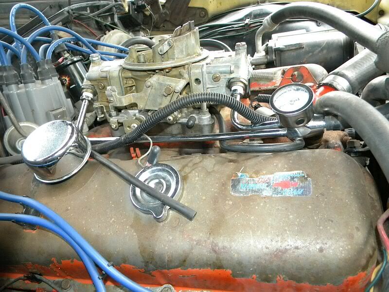

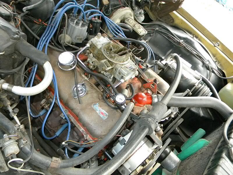

                            Today, I did some cleaning out of the storage closet and in the process had the drag radials out. I looked at them, then the car, them, the car. Well, you can guess the end of this. Yep, they're on the car. I have to say the car is looking less and less like granny's bingo mobile.
                            I also decided to see if the Holley 750 dp I got works. On it went. I wish I could say that it went with ease. As with all mods, I just needed to fiddle with things a bit.
                            First, there is no ported vacuum port on the carb for the vacuum advance. It's just set aside. Also, the wire for the other carb's electric choke needed to get covered because it's ignition hot. I used a rubber vacuum cap.
                            This vacuum thing-em-a-bob is for the AC. When the vacuum gets low enough, it cuts power to the AC compressor. The AC won't work without it hooked up. I had to move it aside to get the DP on.
                            I grabbed the old fuel log from the Proform carb. It needed some bending and prodding to get it to work.
                            After I first started it, the idle speed was way up even though the idle speed screw wasn't touching the linkage. So, off came the carb again. Turns out the high speed idle screw for the choke was bent and stuck on the choke linkage. A little bending and everything was okie dokie again.
                            There, it's on. And, it actually runs decent. I'm not a fan of the progressive linkage. And, I would want a primary metering block with a port for the vacuum advance.
                            I may pull the base plate off the Proform carb because it has a ported vacuum hole and the standard linkage. I'd like to see if there is a difference.
