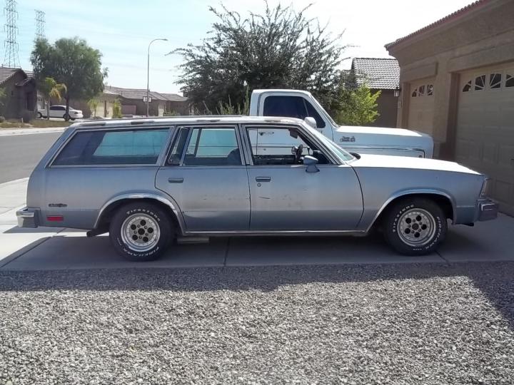

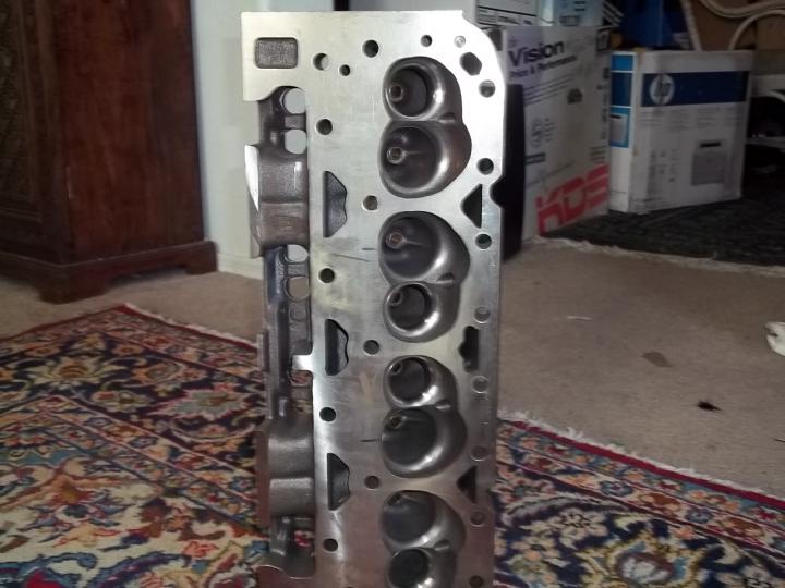

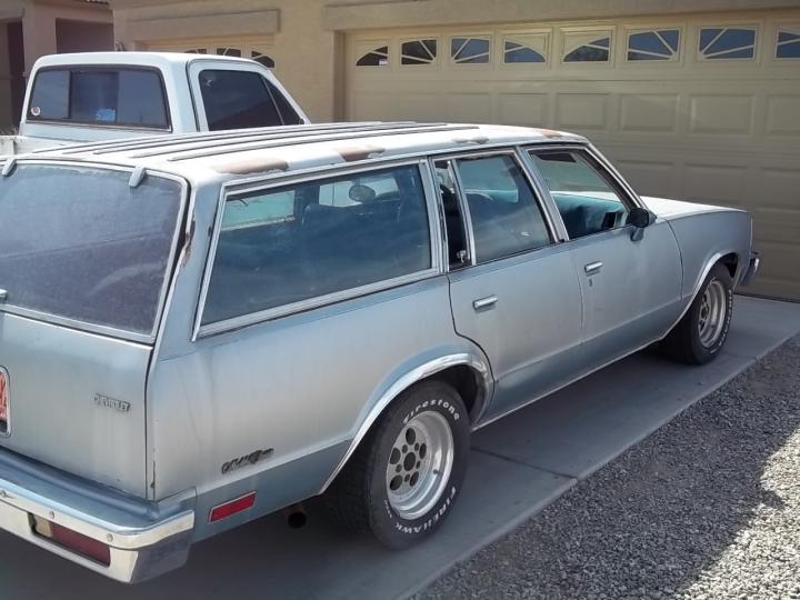

    Someone wanted to see the Malibu Wagon, here are some pics along with parts that I'm using to build a 355.
    Should be a straight forward engine, 010 2-bolt block, Dart 200cc blem heads, Scat rods w/older L2304 pistons and complete Crane valvetrain componets. The rearend is Dana 44 from a gbody out of Mexico. I'm currently shopping for a crank, just gotta get the go ahead from the boss.

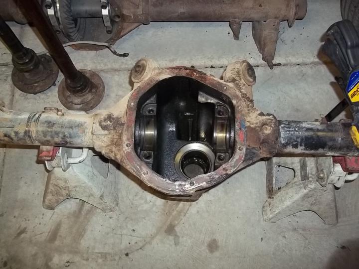

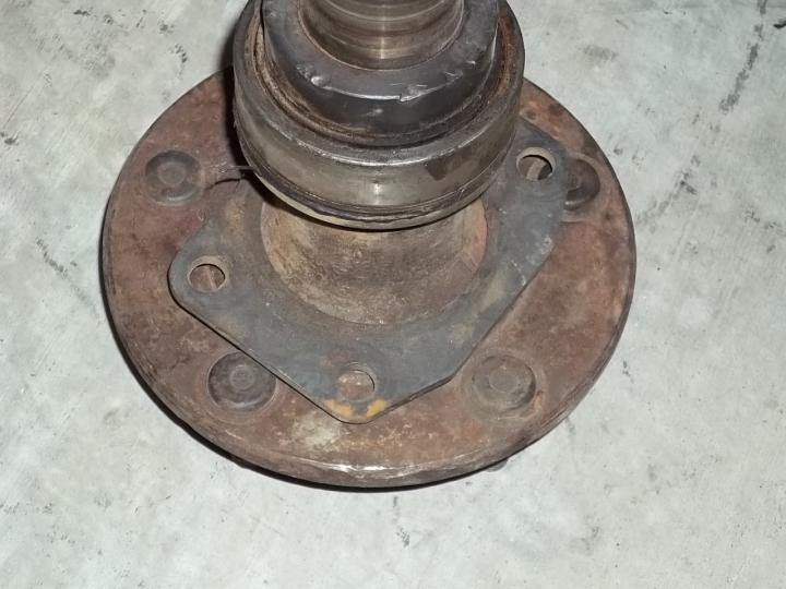

            Got the thing up in stands and the pinion seal started puking like bad! Pulley the axles, brakes and cover, this thing has Mopar ends on it with Chevy brakes!
            • pizzandoughnuts
              • Sep 2009
              • 27
              #21
              It does have all the correct G-body brackets and spring seats. The axles are pretty big 30 spline, with 4 3/4 bolt pattern.

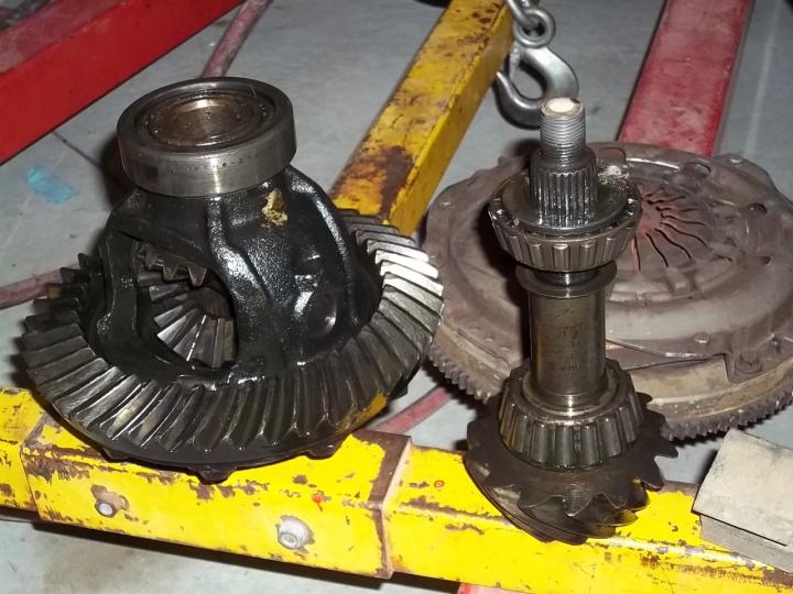

                Found the Spicer numbers on the ring and pinion, the BOM or the bill of materials number is 30060, looked up and that is a good number. Then found 43 14 at the end, a 3.07 gear not what I want. Maybe if I was going to have a 555+ ci BBC with a big ass turbo and a cooler. Sure make donations!!!

                  Found this casting numbers from the mold on the inside of the housing, and was able to find the BOM number for the housing: 751455- 3 and also a date 5-12-80. And all this time I thought that these were put in Mexico G-bodys for only one year. I found a build sheet that a guy posted from his 1986 Monte SS that had a 350ci, a 4-speed and a Dana 44.
