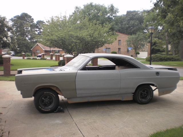

    Nice still overcast dry morning. Got myself out to the garage at about 7AM, before anyone was stirring in the neighborhood, and laid the first coat of high build on everything except the front fenders. I've noticed a couple of lingering imperfections in them that will take more than primer to sort out.
    Anyhow, here's what things look like at the moment. Now back to the sanding.

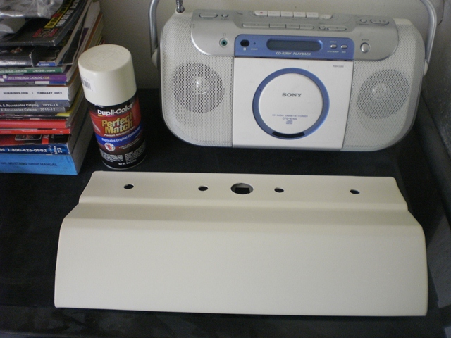

      Interior Color Match

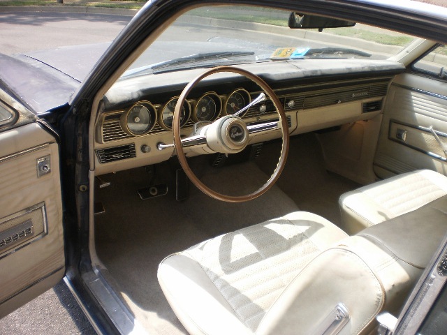

      Thought I'd do something different today...nothing complicated or requiring much energy.
      VIN decode indicates the car interior is "white with black accents" and "parchment" upholstery. Hard to tell after 45 years of wear and abuse, but parchment looks like nothing more than very dirty white. Ditto for the white in the "white with black accents".
      The first two photos, taken a year ago, makes it look much better than it really is.
      My challenge then? What white to use. I went to O'Reilly's and picked up a rattle can of DupliColor Wimbledon White. Eureka! As the photo of the freshly painted glove box door shows, it seems to be an exact match. I'm going to lightly color sand it and then hit it with a coat of gloss clear -- see if it still looks OK.
      Michael from Hampton Roads
        #243
        never noticed - 4 electric panel switches, cool! How many of them had electric windows? Did you mean to match the radio?

                Last Coat of Hi-Build (All One Color!)
                Another perfect morning for driveway painting...high light overcast, about 75 degrees, no wind, all the neighbors snug in their houses (probably having a sleep-in). After several dozen hours spent attending to minor blemishes and imperfections over the last two weeks, this is the last coat of hi-build. Hood and front fenders just sitting in place (mind the gaps!).

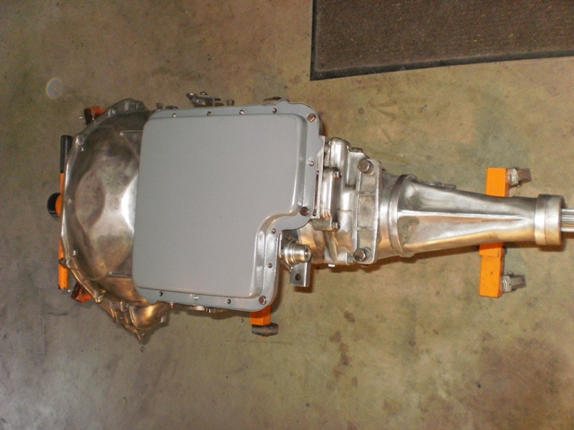

                  Transmission Jewelry
                  This, plus a new front seal and fresh fluid, will be the extent of my C6 refresh. Figure the extra fluid can't hurt and being able to drain/replace it without dropping the entire pan is a big plus.

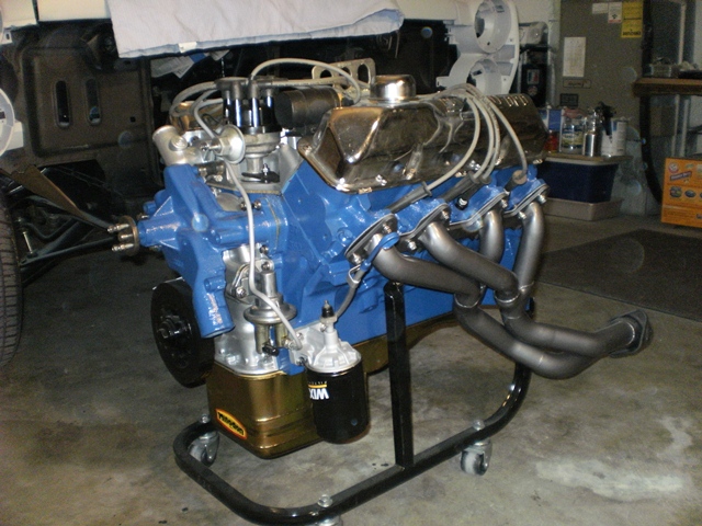

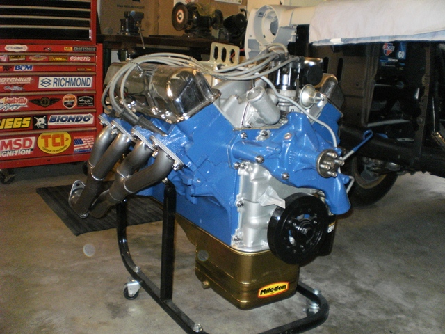

                    Header Test Fit Out of Car
                    The FPA headers are an exact match for the GT head exhaust ports -- thanks Stan!
                    Hopefully when the time comes this drops into the hole without too much difficulty.

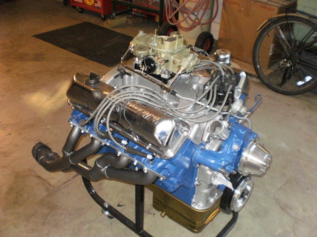

                            More Engine Bits
                            CVF pulleys arrived in the mail, they are very nicely done and competitively priced. As I bought it the car came with an Edelbrock Performer carb; understand they work well but aren't at all period correct for this generation of Ford. So I sprang for a Holley 4150 with a 1-in spacer. Fingers crossed on clearance with the Crite's hood.
                            Now I have a new passion: understanding Holley's -- even bought the DVD for what is supposedly the most tunable carb in existence
                            Its been suggested over on Jay Brown's FE forum that a 1.5 quart pressurized oil accumulator is great insurance. Sounds kind of racing-like to me.

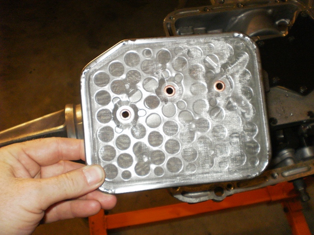

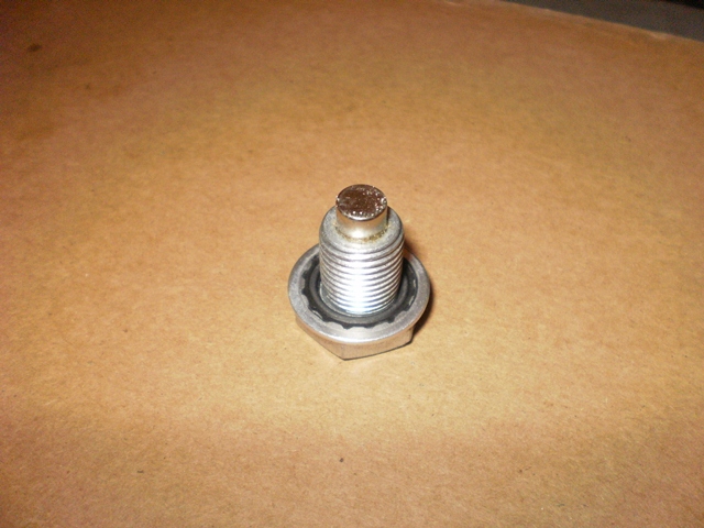

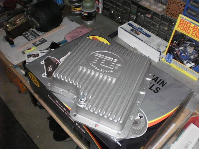

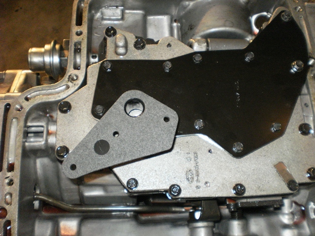

                              Transmission Pan Swap
                              Spent this evening replacing the stock steel pan with the massive aluminum TCI piece. Photos tell the story. Here's the orig shallow steel pan and filter, followed by filter removed, new extended filter installed, and then the TCI pan. Drain plug is magnetic and the extra quarts can't hurt. who knew, apparently have to use TCI fluid for the pan to have its greatest effect.
                              Scepticism setting in: now sitting with a bourbon, OJ and soda to consider the pan/fluid relationship.
