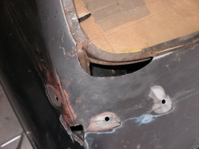

              Rear Window Channel Fix Stage 1
              Thanks to a toxic combination of the elements, a vinyl top and associated trim, the rusties devoured a chunk of rear window channel. Top photo shows what things looked like when I took possession of the car. Bottom shows the rot cut away. Going to make some templates out of cardboard and cut/shape sheet metal for the repair(s). Also have to weld in the trim holes.
              Sayonara vinyl top.

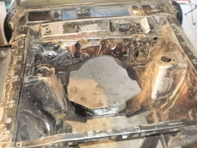

                Front End Clean Up 3
                Here's what things look like today, after yesterday's degreasing and cleaning effort and a couple of passes with the angle grinder and wire brush attachment this morning. Once I've got the Swiss cheese firewall sorted I'll hit it with primer and black underhood paint.
                Michael from Hampton Roads
                  #98
                  WOW Nice work! that's a lot of work! Simple green straight works even on 50 year old chassis gunk? impressive.
                  Did you clear the bare steel fuel tank or is that silver paint? I'm not sure if I'm going to clear or black the falcon tank before I put it in.
                  (after the mini tub work is done).
                  • mlcraven
                    • Sep 2008
                    • 1878
                    #99
                    Not just Simple Green. Started scraping by hand using a putty knife, then Engine Gunk after I warmed up the garage, then Simple Green with lots of hot water and a good stiff scrubbing brush.
                    Similar process for the gas tank, except outdoors. Scraped all the undercoat and crud off first to get down to bare metal, then hand-rubbed with increasingly finer grades of steel wool and finally a Scotch-Brite green pad. Once it was nice and shiny I rubbed it down liberally with Liquid Wrench silicon spray. Pretty effin' labour intensive but my time is the cheapest thing in this project.
                    The tank is only sitting in position right now (easy storage!). Once it goes in for good I'll probably give it some coats of clear.
