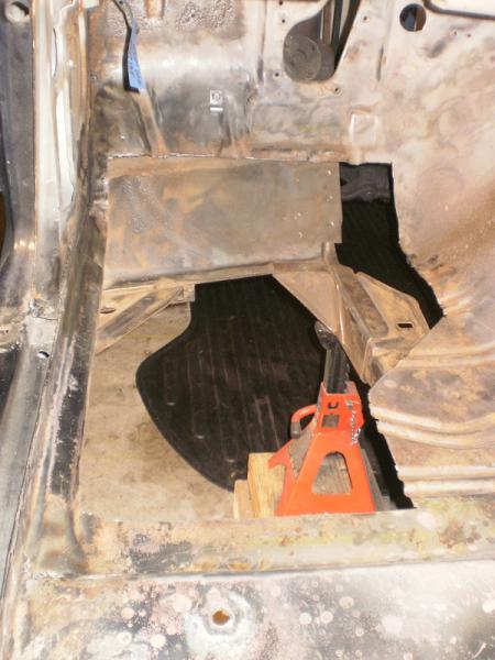

    Spent most of yesterday chipping off undercoating and general crud -- in the process revealing more unpleasantness. The front floors are in much worse shape than I thought, as are the toe boards.

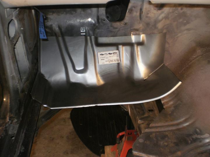

            Finished cutting out rusty front floors. Once the undercoat et al was chipped/scraped/wire-brushed off the rot was everywhere. So now the toe boards will be replaced too...good job the aftermarket has them. The test fit looks promising.
            Dash is completely stripped and wiring harness out, including miles of power window wiring.
            As for chipping, scraping and wire brushing the chassis, I'm calling it quits and settling for 'good enough'. The objective was to find out where the rust was and I succeeded. Without a rotisserie aching bones and muscles will take no more.

              Hard work but this is the difference between "cobbled up" and "NICE CAR". You'll feel better knowing that what's under that carpet is right.
              Carry On!
                #67
                That is a lot of work - most of which I have ahead of me on the falcon.
                Where did you get your floor patches from? The fit looks good in pictures.
                I don't think I need complete patch panels - but it may save me some time over starting from scratch.
                    From Mac's; they're actually for the 66-67 Fairlane but work just fine. The catalogue also says they'll fit 68-69 Ford/Merc intermediates as well, but more massaging required. Even these are going to require some amount of tweaking to get a proper fit, but nothing that can't be done with basic hand tools in the garage.
                    Mac's has two catalogues: 1960-70 Falcon/Comet and 1962-70 Fairlane/1968-71 Torino. The Falcon/Comet catalogue has lots of sheet metal for 60-65 Falcons but nothing for Comets; the second catalogue has loads of Fairlane sheet metal, some of which -- fortunately -- works in the Comet line. No surprise, there are a lot of identical part numbers between the two catalogues, but what is odd is that sometimes the prices for the same part # are different between the two. What's up with that?
                    Anyway, just glad to have something that works...not inexpensive, but works. And yeah, the time-saving aspect of buying a decent quality pre-formed panel is very compelling.
