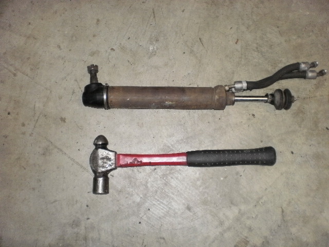

      Second appointment with the PS slave cylinder occurred this afternoon, yielding the desired result. First I removed the entire center link assembly, then set things up on a couple of blocks of wood, and a few good wacks on the castle nut with the device on the bottom removed the object on top.

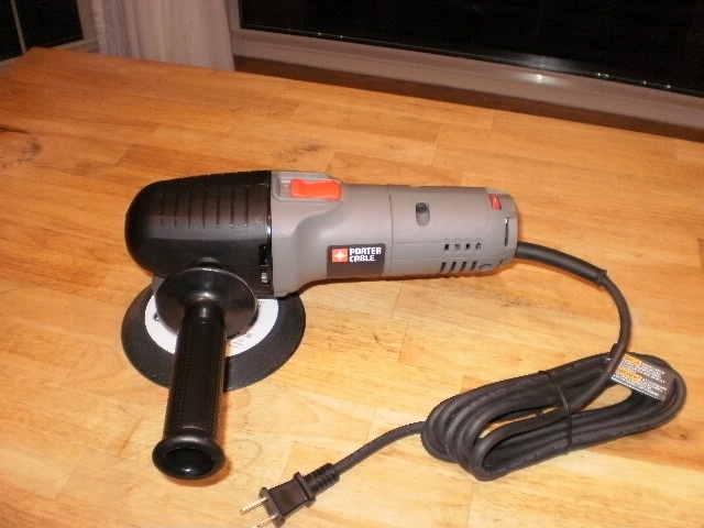

        Santa is a fan of Porter-Cable products. ROS and polisher, which I hope to get lots of use out of over the next 4-6 months. The theory is that having this negates the requirement for a DA sander and a compressor with the ooomph to run it.

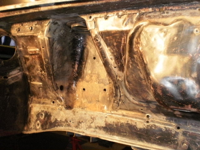

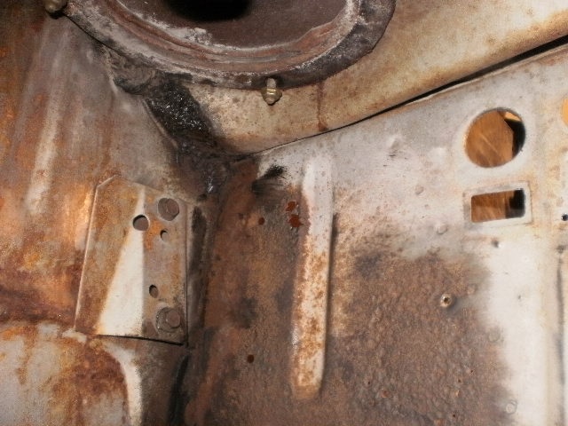

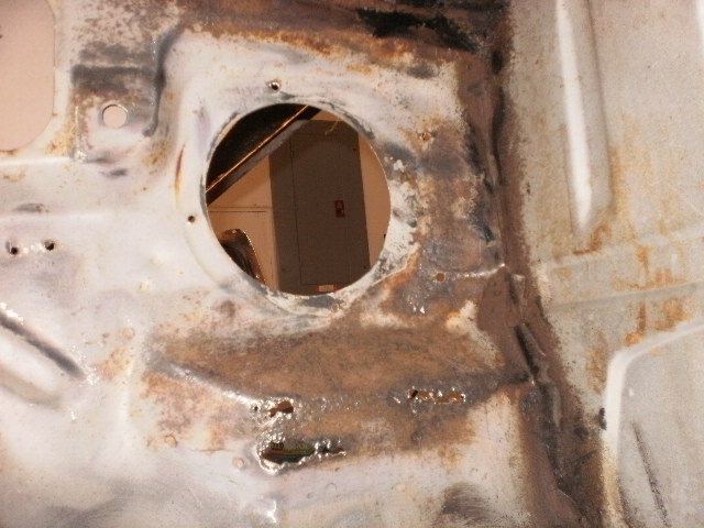

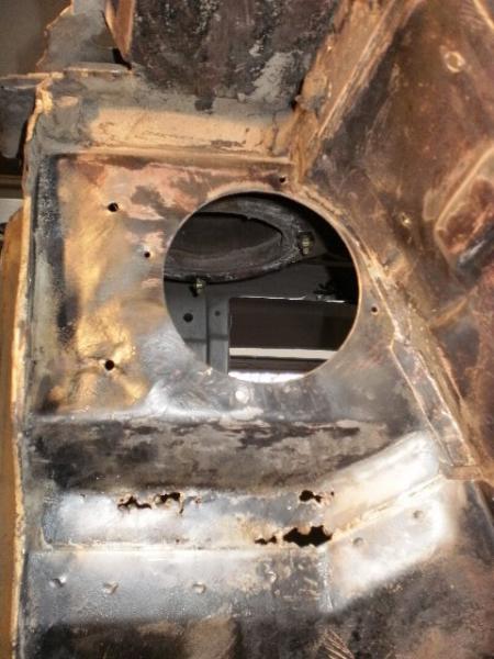

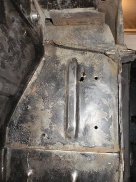

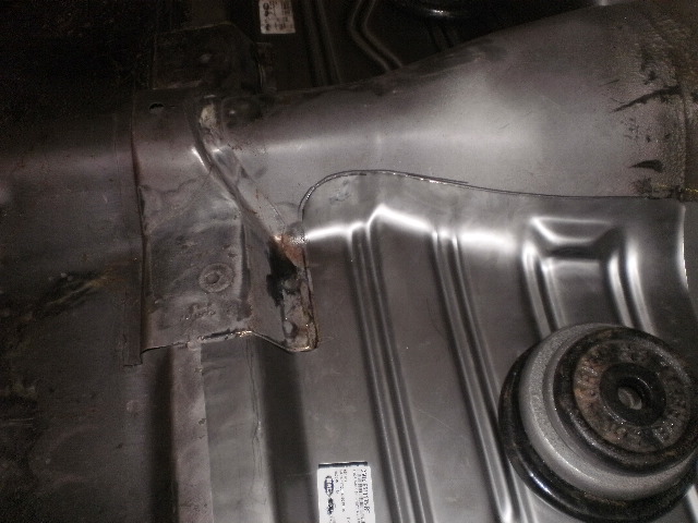

          Investigation in advance would have revealed Fords of a certain style and vintage suffer from rusted-through firewalls, brought about by wet firewall insulation.
          Attached photos indicate the extent of the ugliness.

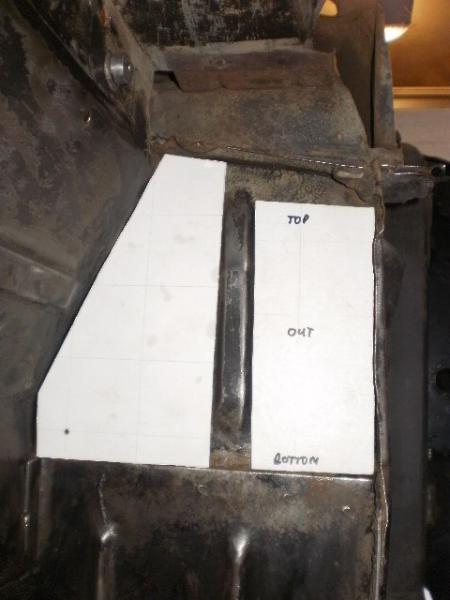

          Repair plan: (1) trace cardboard templates for sheet metal patches; (2) weld the patches inside the rear of the front fenderwells on the front side of the firewall over the bad metal, and (3) treat the repair with POR 15 so it doesn't happen again.

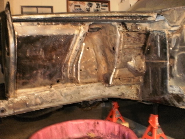

                  Have to get busy and hit the front end with Gunk followed by hot water and Simple Green. Photos below show the current state of affairs with the front end completely stripped and the undercoat and larger bits of crud scraped off. Messy.
                  Sorry about the fuzzy photos.

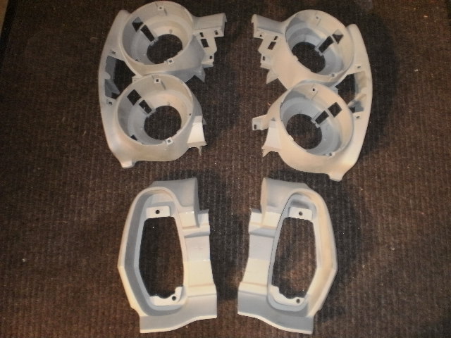

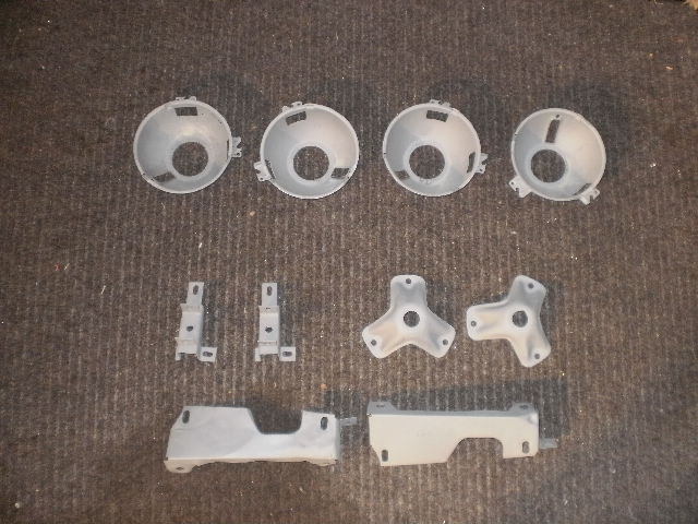

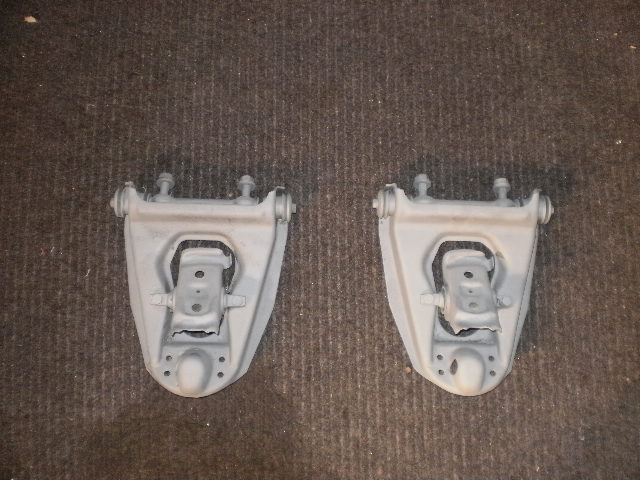

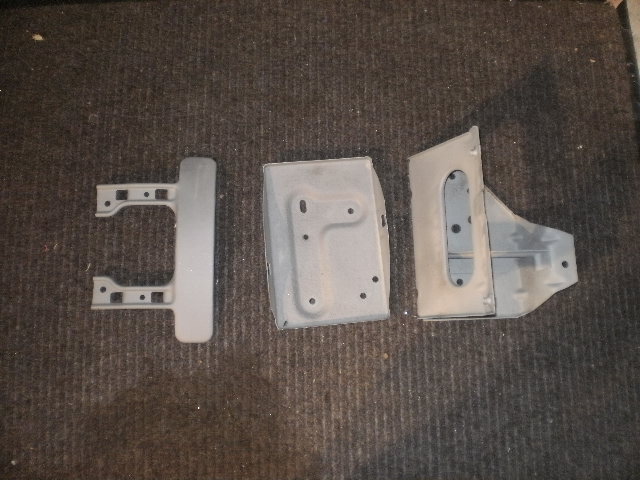

                            Late this afternoon I received word from my man Aaron Bloch at Flatlander's Media Blastery on 25th St here in Norfolk. The several small components I took into him in early December were complete so I picked them up after supper. Aaron works the night owl routine, it's the only time he can get real work done because car guys are always dropping in to chew the fat through the day (full disclosure -- I'm one of them). Anyhow, pics below of fan, exhaust manifolds, fender extensions, headlamp pots and various brackets, upper front control arms, upper rad support, battery tray etc. As soon as it warms up I'll shoot some self-etch on all of it and then hit the non-body bits with shades of black from rattle cans. Also get some Calyx manifold dressing on the exhaust manifolds.
                            This is the only blasting I'm doing, after my experience with the El Camino ten years ago I'm NOT going to touch the body with media. Shit was coming out of nooks and crannies for months afterwards

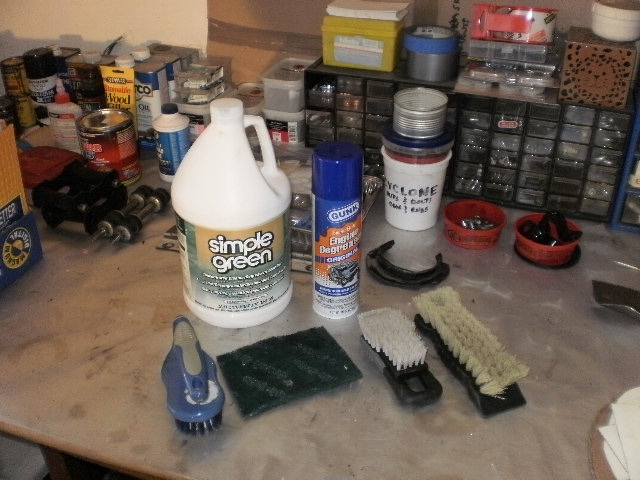

                              Finally got at it today -- more messy work and at the end of it all the before and after pics looked exactly the same. But the caked on grime and grease -- mostly from the leaky power steering system -- is gone.
                              A smarter guy would have used a 3000 psi pressure washer before putting the car in the garage for the winter and removing the front suspension. And a more careful guy wouldn't have ripped a fingernail. Fortunately, Gunk, Simple Green and hot water seem to have excellent disinfecting qualities.
                              The kiddy pool continues to take a beating in a good cause. But the garage floor is spotless.
                              Elbow grease courtesy of your correspondent. The tools below:

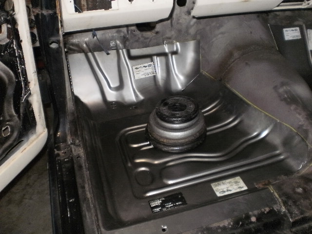

                                More Floor Sheet Metal Work
                                This afternoon I massaged the front floor replacement sheet metal into place. Required some trimming of and hammer work on the prefab panels from Macs. Went through four jig saw blades but very pleased with the fit after all that. Next chore is to weld them in.
