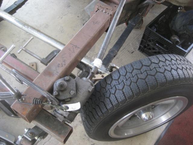

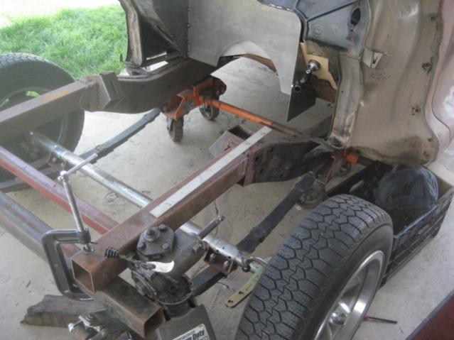

    Changed my mind on the steering - the Mustang box was going to mean that I had to modify the radiator support so I decided to use a 60s Chevy truck box mounted on the outside of the frame. This also means I can mount the box a bit further forward and get the drag link lined up better. Also been mocking up the column mounting and trans tunnel.

        Is there going to be an issue if you hit a bump on a hard right turn, like going into a driveway? Tire looks close to the box location.

          There's actually more clearance than there looks in the photo. The box is going to come forward slightly from there too which will increase the clearance.

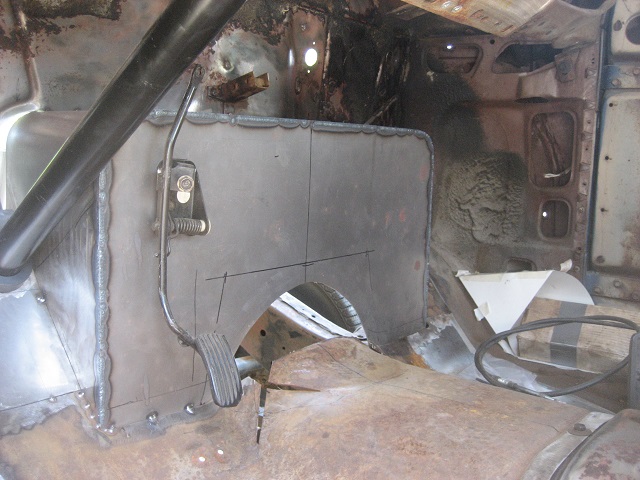

            Yep, made a bit more this weekend too - tacked a steering column drop together and finish welded part of the firewall. Also found the parking brake handle at last and bolted that back in so I know how much space I've got for the brake pedal.

                That steering drop looks great! I'm still trying to figure out where to mount a gas pedal! One of the drawbacks of having three pedals and so much firewall setback!

                  That's a neat collar at the firewall end of the steering column......where did you source that?
                  I could use something similar on the TR7 - apparently the Brits decided that end of the column could just "float". Looks like your collar would fill the bill perfectly.
                  This is an awesome build, thanks for sharing with us!

                    Thanks! I think they're easier than setting up an independent though - fewer adjustments.

                      I was going to put a clutch pedal in this one in case I put a 4 speed in it later but decided it was going to be too much trouble - how's the Falcon coming on anyway?
                        McMaster Carr - they have all kinds of shaft collars
                        McMaster-Carr is the complete source for your plant with over 595,000 products. 98% of products ordered ship from stock and deliver same or next day.
                        I used one as part of the column drop too.
                        Glad you like the build, I'm looking forward to seeing progress on your TR7!

                          About ready to pull the engine and build it. The drivetrain and suspension/steering is complete. Should be driveable in a couple months.

                              Acheived a milestone today - rolling and steering for the first time since I took the original suspension off. Also got a brake pedal in there. And now it's back in pieces so I can finish weld the frame and brackets...
