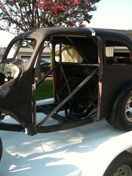

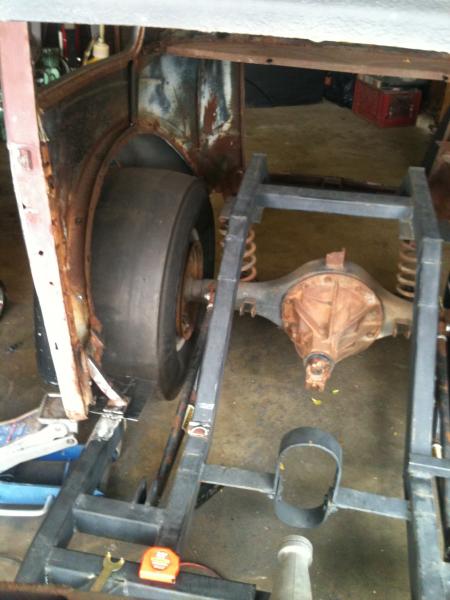

    Anyway, about the car. I acquired it 4 or 5 years ago from a buddy of mine. He had it sitting out at his place in the high desert for a while with some plans to build it. Well, that changed when he managed to score a complete vintage 60's Anglia panel (Thames) gasser out of someones garage in, I think, the Victorville area. It's extremely cool and I'm very jealous. So this Anglia sedan became available. I've always wanted one so I asked what he would take for it. He replied "Trade me a guitar for it". Since I have 20+ guitars in my collection, I said "DONE!" I traded a nice 1994 USA Fender Strat in a tweed case for the car. So, I've put away a few parts for it here and there and I've finally managed to actually get started on it. As you can see in the photos, it's just a shell on a chassis that had alredy been back halfed with a ladder bar setup with a narrowed Old/Pontiac rear end. I'm planning to keep that but add coilovers in the back. The front has an Opel front end grafted on. The jury is out on whether I'm going to keep that. I like it, but the tires stick out of the fenders. No good. If I can figure out a way to make it narrower, I'll do that. I have a complete fiberglass tilt front for it, it had fiberglass doors but I traded those for some stock steel doors.

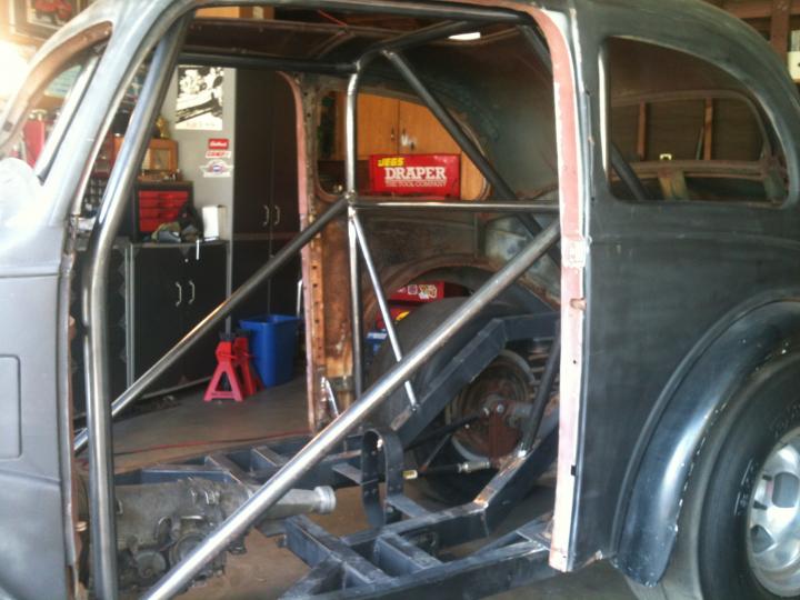

    So, over the last couple of weeks I managed to get my first real work done on it. I ordered a 10 point cage from Jegs, and tacked it into place. Now, I'm trying to learn how to weld, and I think this is a great project to learn on. BUT, the roll cage is not the place to learn (I make pretty good booger welds at this point). So, I custom fit all the cage pieces and lightly tacked it into place and I'll have a real welder finish it up for me. I have a couple of chassis guys in mind. So, this is where we are with it right now, it'll be a slow moving project, but I'll update once in a while. I know there are some gasser guys on here that will dig it!

                Just got the car back from my fabricator friend in Bakersfield. He did all the final welding on my roll cage and it looks great. AT least I know that part is done correctly.... I just ordered a rear coilover kit from Jegs, so thats the next project on my list. I'm going to do the welding on this myself, so we'll see how that goes....

                    Let me make a suggestion on the door bars, depending on the sanctioning body wherever you might race it (this is OK in LSR). S&W Racecars makes a swing out door bar kit that allows you to remove the pin and one bolt and take the bar out of your way. This is a HUGE help in building and installing a dash, doing wiring, etc. I plan to make this mod to the S-10 soonish so I can install the pedal set from Phitter - it's pretty inaccessible as it is.

                      I may do that Dan, we'll see how difficult getting in and out of it turns out to be. Right now it's not hard to step in and out. I'm pretty sure swing out bars are legal. Also, I don't plan to run the car fast enough to require a certification.

                        Front suspension will be interesting... I see how narrow that is. The one linked to earlier may have some good ideas...

                          Great decision on the cage. That's certainly something a pro should finish up.

                            Yeah, the front suspension is the most troublesome part of this project. I can get a complete Mustang II setup from Fatman Fabrications, but as always, I don't have the budget for that right now. So I'll try and work with what I've got, I think I can cut a few inches out of the middle of it and make it work. I'm not in a hurry with this thing, so why not? If I screw it up, I'll just try something different up there.
                              check out welder series - SBG turned me on to them - I believe he used their M2 kit in the front of his caddy powered sports car project - basically the parts show up as flat plate patterns mostly cut out save for a few small pieces holding it all together - you fold the parts into shape and weld them up. Very cost effective - and easily modified for width in your case... then it's just a matter of finding a narrower rack for the steering, or shortening some tie rods perhaps.
