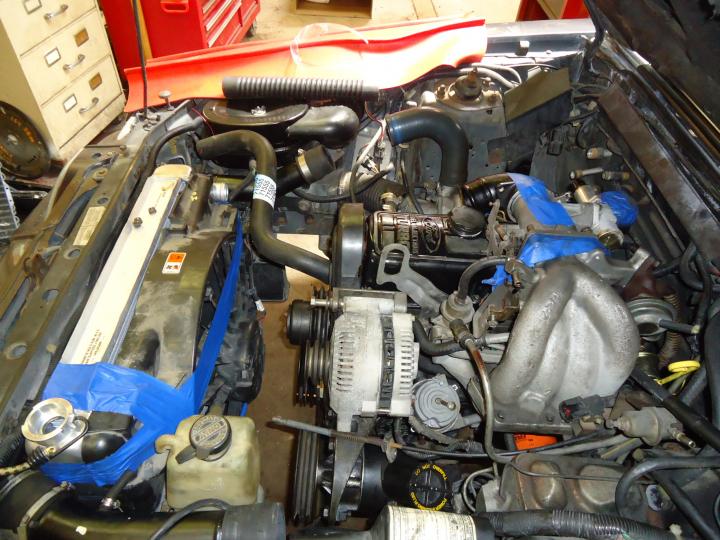

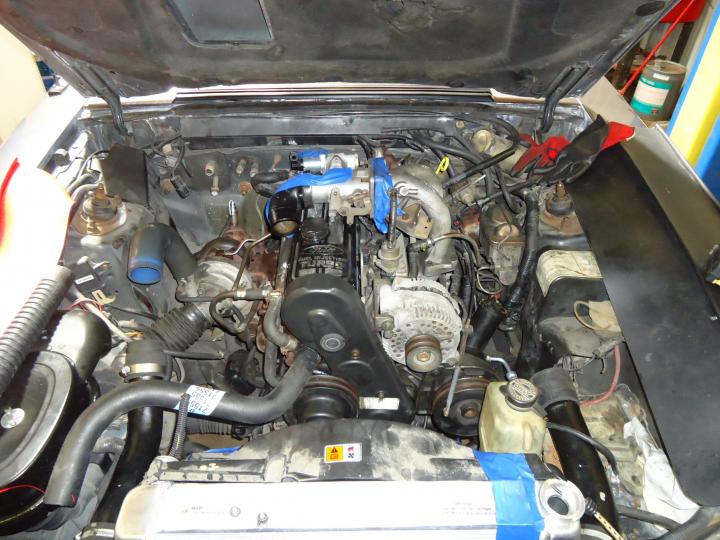

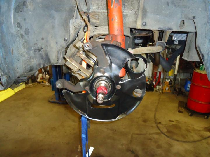

      Today spent time working on brake cooling and radiator mounts. Sourced a 2008 Mustang cooling fan from the local junkyard, which is the same one used up to 2013 on all models including the Boss so should be plenty of air flow, plus its a dual mode fan (will have to figure out how I want too wire it). The fan fits great with the new radiator - Still need to iron out a mounting strategy.

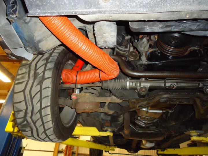

      Based on work experience with brake cooling i fabbed up the front disk brake shields w/ provisions for the cooling hose. Package is tight and i couldnt get as close to the center of the rotor hat as i would have liked, but it'll cool much better than stock. The setup is mimicking the ducting on my Boss Laguna Seca. Also plan to use deflectors in the rear to channel air to the center of the rear rotors similar to how Porsche 911 does.

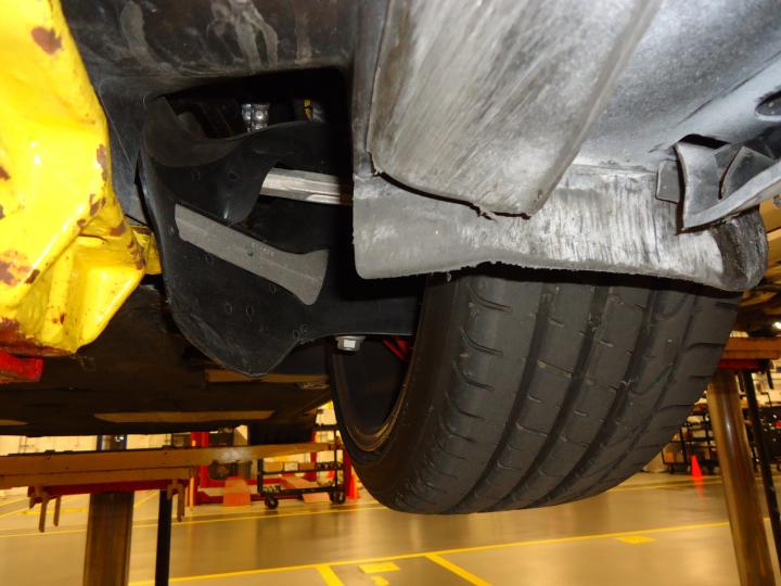

      Porsche design: Click image for larger version
      The new cooling module assembly is quite heavy and hope that removing the AC system offsets the weight increase. Good thing though is that the module is about 2" car rearward which will help weight distribution.

        Still waiting on the intercooler plumbing, but the brake cooling hoses arrived.
        They rub at full lock and close to full lock, but that was expected with the tight package. I'll add a protection plate so when the rims to rub, they rub on a plate and not the silicone hose.

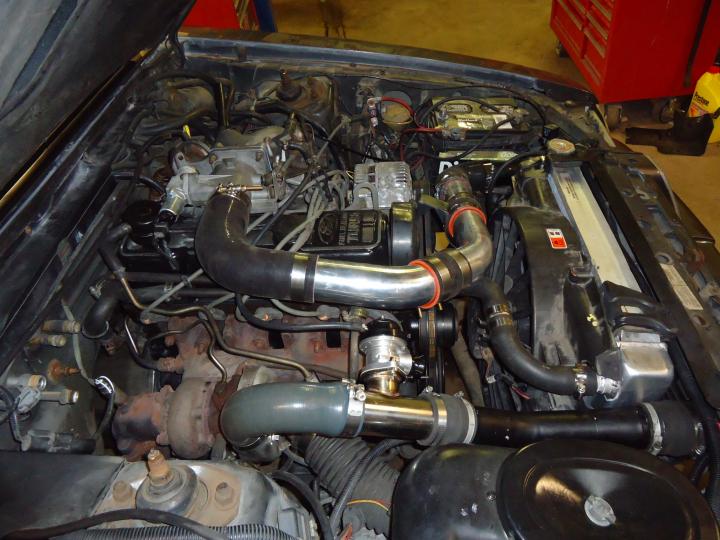

          This weekend, was able to finish the mounting on the radiator fan and the radiator. Also finished the intercooler hose routing; going to go to a 90degree rotated '86 style intake, but dont have it yet so this one will suffice for now.
          Blow off valve has not arrived yet, deadbeat ebay seller hasnt sent the part yet, so went to another site for the BOV.

            Finally received the last parts i needed for the turbo ducting (BOV). Installed it, plus a new starter. Found that it was a dead battery that was not allowing the car to start, will have a new battery soon but was able to jump it with spare battery John had.
            Car started up quickly and oil pressure was great. It dropped a bit once it was warmed up but I plan on using a thicker oil at the track anyway.

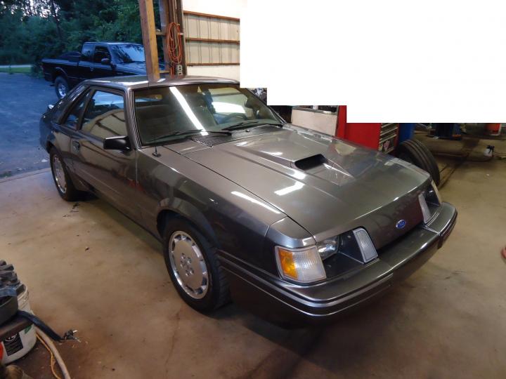

                      Back on the road!
                      Finally after 6 week of work the SVO is back on the road. Finished the 4.10 gear install on Saturday and went for a quick spin around the block. The manual boost controller and the BOV make a huge difference to how the car makes power....going to need to spend more time investigating the boost controller as it seems the internal waste gate cannot keep up with the new system....I can hear it venting boosted air, but the engine is still seeing over 18psi. perhaps it has something to do with the location of the factory gauge...will hook up a gauge at the intake to get a more accurate reading.
                      Car will definitely be interesting to drive on the track...it feels very binary; will take some effort to learn how to modulate the throttle with how hard the turbo is hitting.
                      4.10 gears seem a bit short for the street! Have always had 3.73's w/ my mustangs; this is my first experience with that high of a gear ratio.
                      All in all the car seems to be responding to the new mods quite well. Its really hard to stay out of the boost! so fun hearing the blow off valve vent during shifts too!

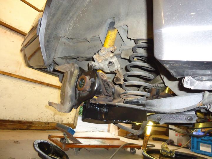

                              Found a set of 2013 Boss rear adjustable shocks on CList last week, installed them on the SVO this weekend... they bolt right up! Now i have 5 way adjustable rear shocks. All they needed was for the lower bushing sleeve to be trimmed down. In compression they are about 1 inch longer than the Koni's, but checked the jounce bumper clearance and to bottom out the Boss shocks it'll take 0.75" of jounce bumper compression to bottom out the shock. I'll be lightening up the car a bit so that shouldnt be an issue. Car now rides like my Boss Laguna!! (put front Koni's on stiffest setting).
