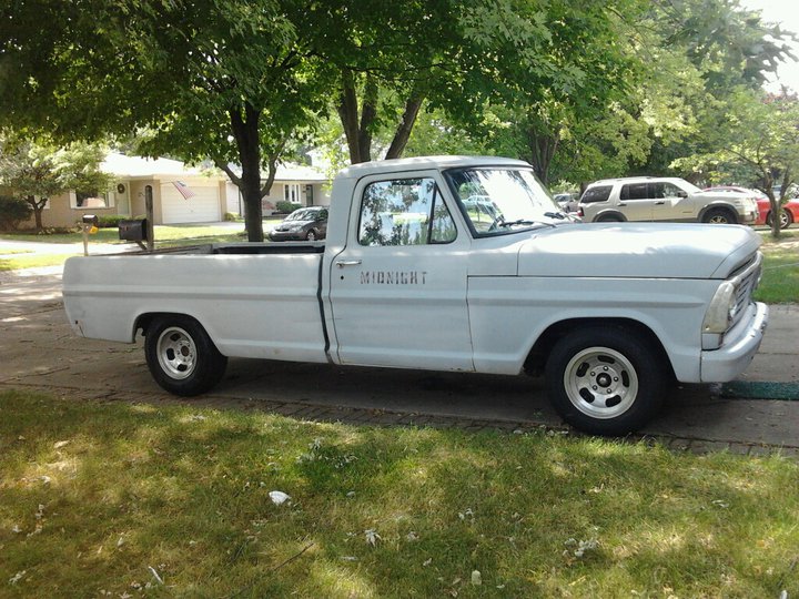

    I bought this truck in 2010 for $1500 for my son to drive to school kinda as a father son project
    when we first brought it home we started looking at it and said .....

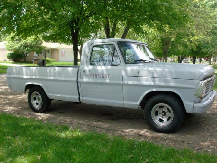

    It needs to be lower so we chopped a coil and a half out of the front and flipped the spring hangers in the back and dropped it 3 inches all around . cost me $2 bucks for nuts and bolts
    he then said ....
    it needs to be hotrod black!
    so after a little research he and I sprayed it with rusteoleum satin black with a harbor freight spray gun
    cost me $75 bucks !
    he graduated 2 years ago went off to college and left it behind for me to toy around in its a blast to drive
    my mother in law made me a blanket seat cover for the 93 F150 seat I grabbed at the local pic a part for $50 bucks
    and I even treated it to parking in the garage this winter
    I have been slowly picking up parts for its next stage
    I scored a low mile 1971 400 engine and c6 trans for $250 bucks
    and I got a 3.73 gear posi 8.8 rear for it cheap too
    today I picked up a 2004 Lincoln Towncar front suspension for $200 so I can do a Fast n Loud style
    suspension upgrade I think Im holding up to the $5000 challenge

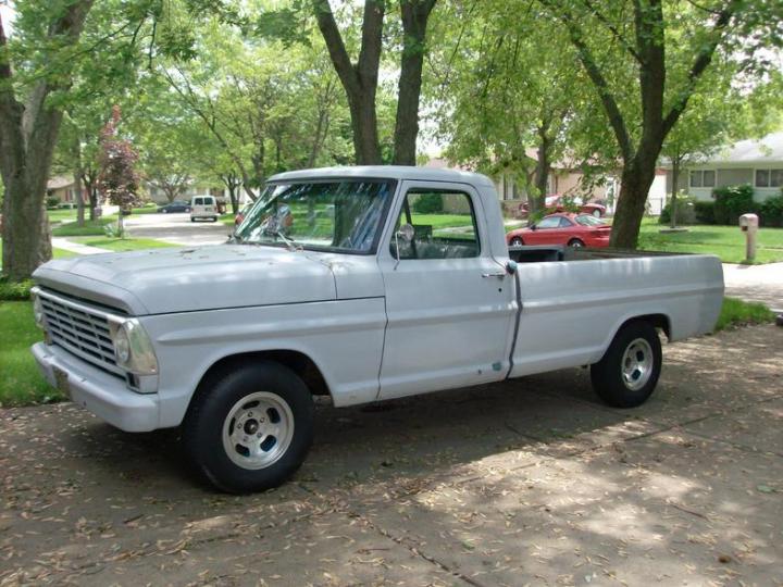

      Yeeeeesssssss. Bump and dent sides are my favorites!
        Smooth looking ride! I look every now and then and never see an affordable Panther front end. I really want to do that to my truck... It would be really nice to not have to "herd" the thing.
        Your truck is really straight looking. Pampered life?
