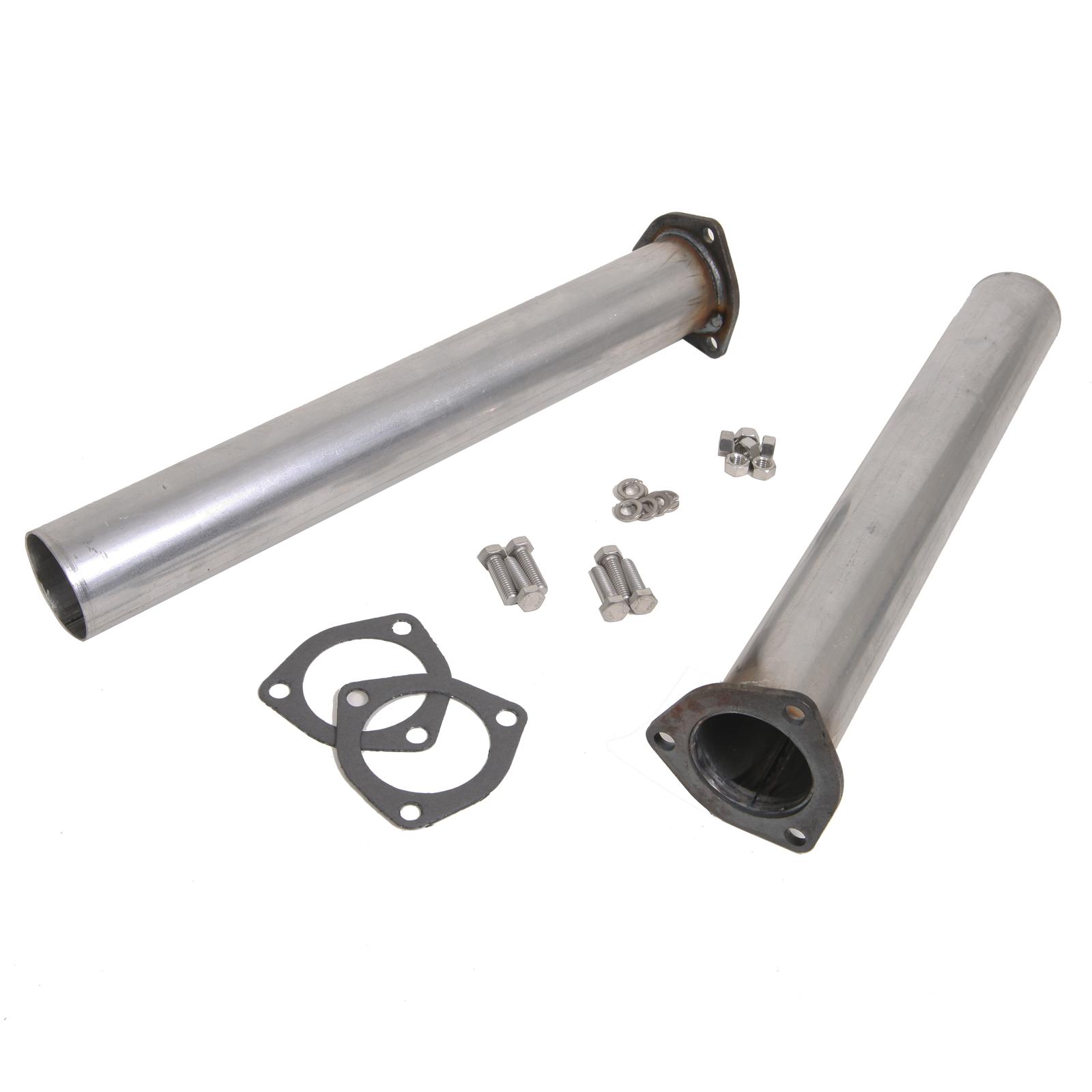

                Oh, and another thing I did was attempt to install the electric cut outs. I thought I had plenty of room, but it appears I only have plenty of room on the passenger side, which of course was the only one I checked when I was fitting up the exhaust.... On the driver's side the parking brake cable comes out of the frame right next to the cut out leaving no room for the motor assembly. Looking at it, if I get some header extensions I can move it out ~6 inches to be right next to the X-pipe and have all sorts of room. So I'm looking at some extensions on Summit but none are flanged at both ends, so I'll have to weld my own flange on them, which I guess is okay because I'll have to cut the pipes down to ~6" anyways. I actually have a pair of steel 3-bolt header flanges I can use.
                The other issue is going to be with wiring them, at least automatically. Seems they are not supposed to have continuous power to them, which is what the megasquirt would provide (as far as I know?). So I'm still contemplating that one, worse case I have to install the manual switch. I have a question posted on the MegaSquirt board seeing if there is a way to set an output to only run for a couple seconds after the conditions are met.

                  I don't think I'd want them automatic....
                  Make sure to wait to weld the flanges until you get the parts on the car and lined up and tack welded where they need to be. Although you probably know that already

                    #2799
                    I'm not sure I'd want automatic cut outs either. Wrong place, wrong time would happen to me for sure. I have the space issue too, so I focused on the best all-the-time-exhaust I could fit. That and the noise level uncorked is track only for sure.

                        The beauty of automatic is it's simple wiring to make them not automatic any more. Either two wires to the MegaSquirt or two wires to the switch. I did think about having a simple ON(auto)/OFF toggle for the automatic controls, so that could over ride it. I figured programming it to open at anything above say 90% throttle (via TPS) would be safe programming. I practically never go WOT on the street unless I'm looking to make noise anyways.
                        I do like the exhaust as it is now though. Tucked up and decent volume level.

                          How do the cutouts work? is it a DC motor that you reverse polarity to change whether it opens or closes? If so, there is a relay that takes a two bit digital input that might work
                          http://www.vexrobotics.com/217-0220.html
                          you send it a digital input on it's two input signal wires, and it controls the power to be off, forward, or reverse.
                          I don't know if there are two digital outputs you could use...my guess is it would take some programming effort to make it work, and I don't know who would do that except maybe Jerry?

                            Been hearing how electrical cutouts dont last very long. Just saw a turbo Neon with one stuck open.

                              Yup, simple two wire DC motor. Does this box interrupt the current to the motor (once it hits it stops) even though the power feed from the ECU is still on? I can easily set two outputs up, one for open and one for closed, and have them not overlap, but the trouble is having the signal from the ECU turn off after a few seconds, as the megasquirt (as far as I know) will keep the power (or ground) going until the conditions are not met anymore.
                              As for longevity, we'll see, I'll have them pretty far down stream in the exhaust, at the X-pipe by the time I'm done. I'll probably keep the block off plates in the trunk just in case one gets stuck open, etc. It's only three bolts.

                                The relay I linked to will put out whatever it's commanded to..... you need to figure out the control system, which might need feedback (limit switches) or a timer.
                                A manual switch will be MUCH easier to figure out.
