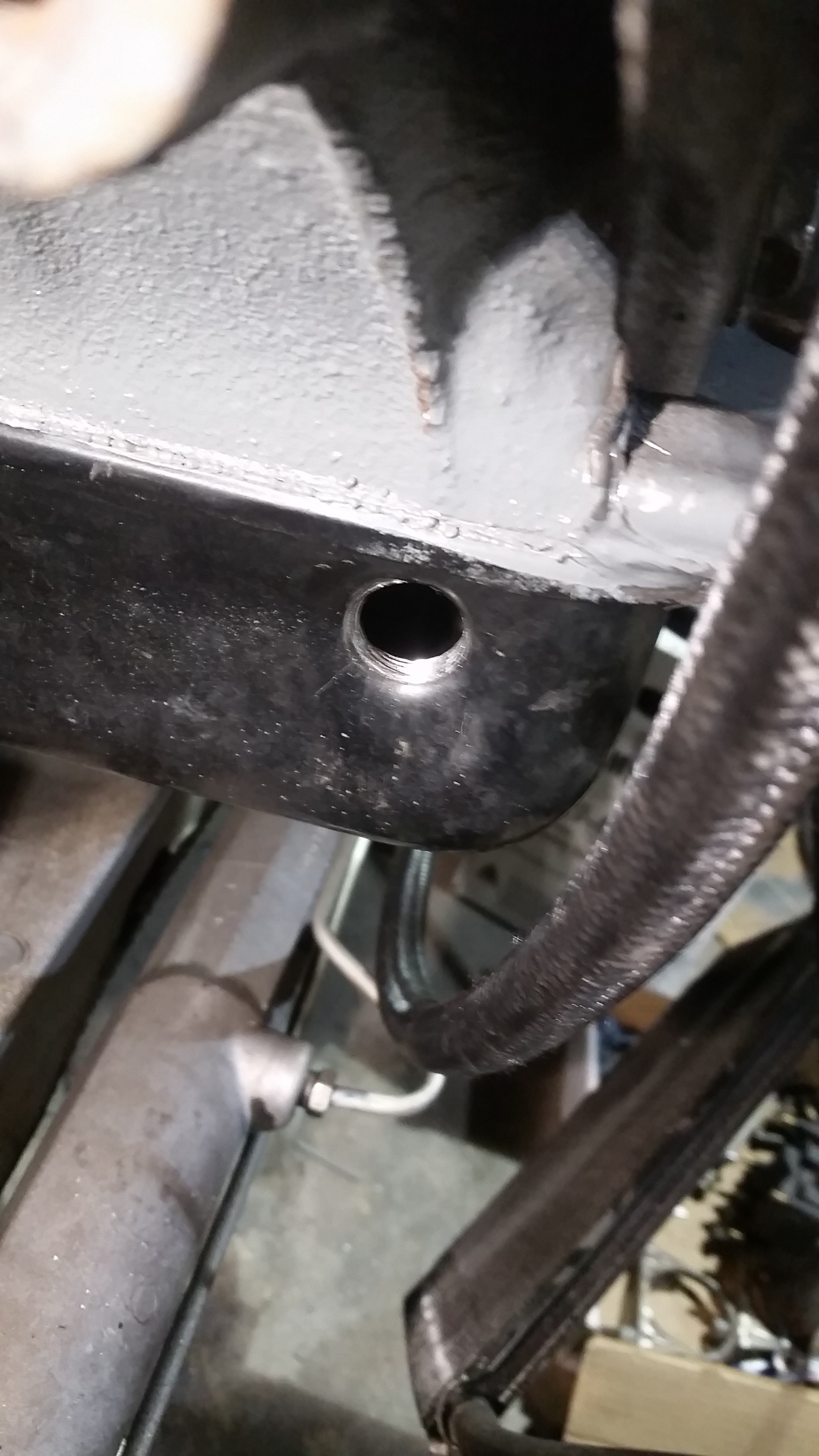

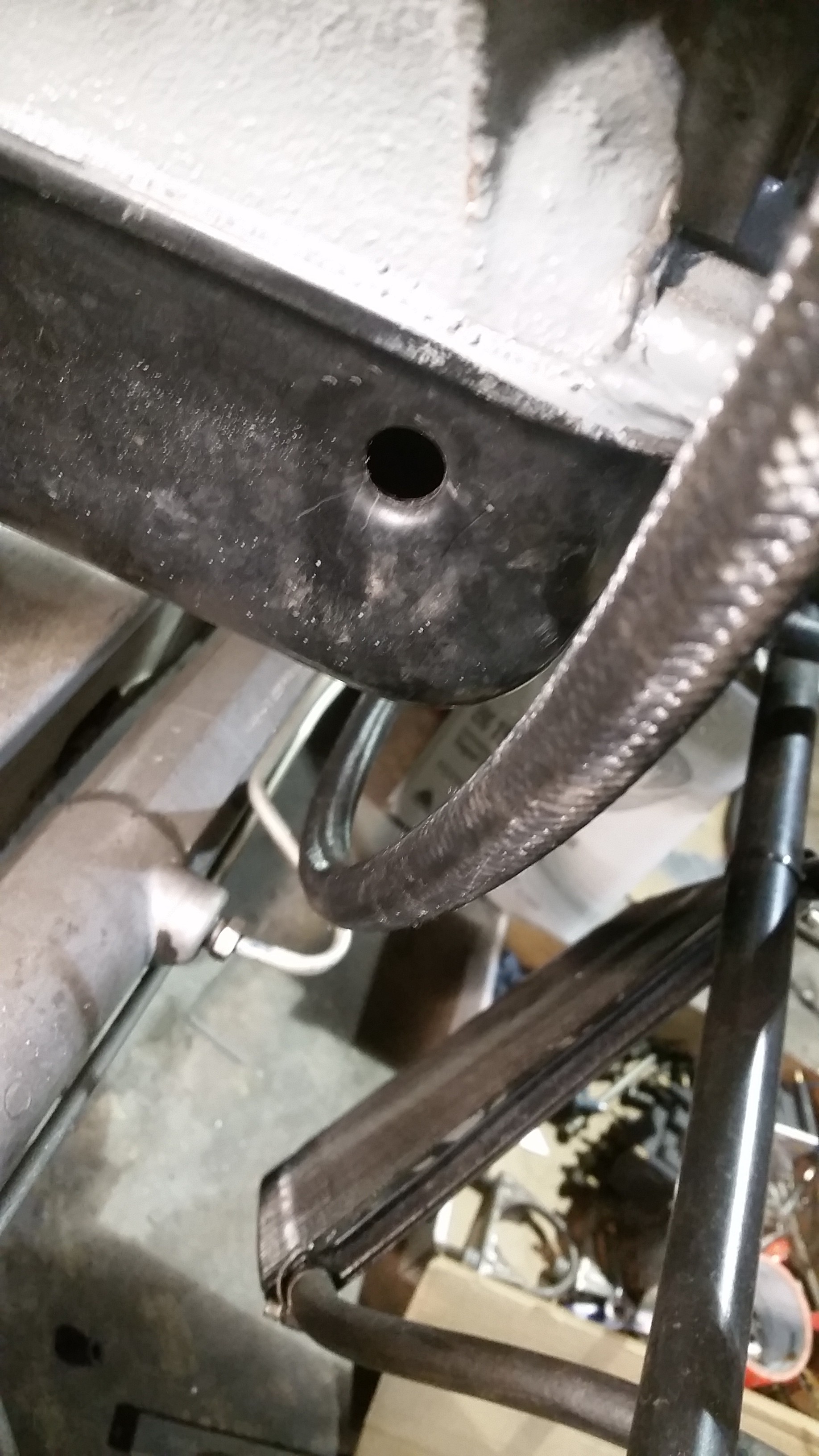

Yesterday was poke a hole in the oil pan day. After researching several ways to do it, I decided to drill a small pilot hole and use increasingly larger punches to stretch the hole until it was the right size to tap with a 1/2" NPT tap. Worked really good! I am very happy with the results. I will add some sealer, tighten it up and it should be good to go.

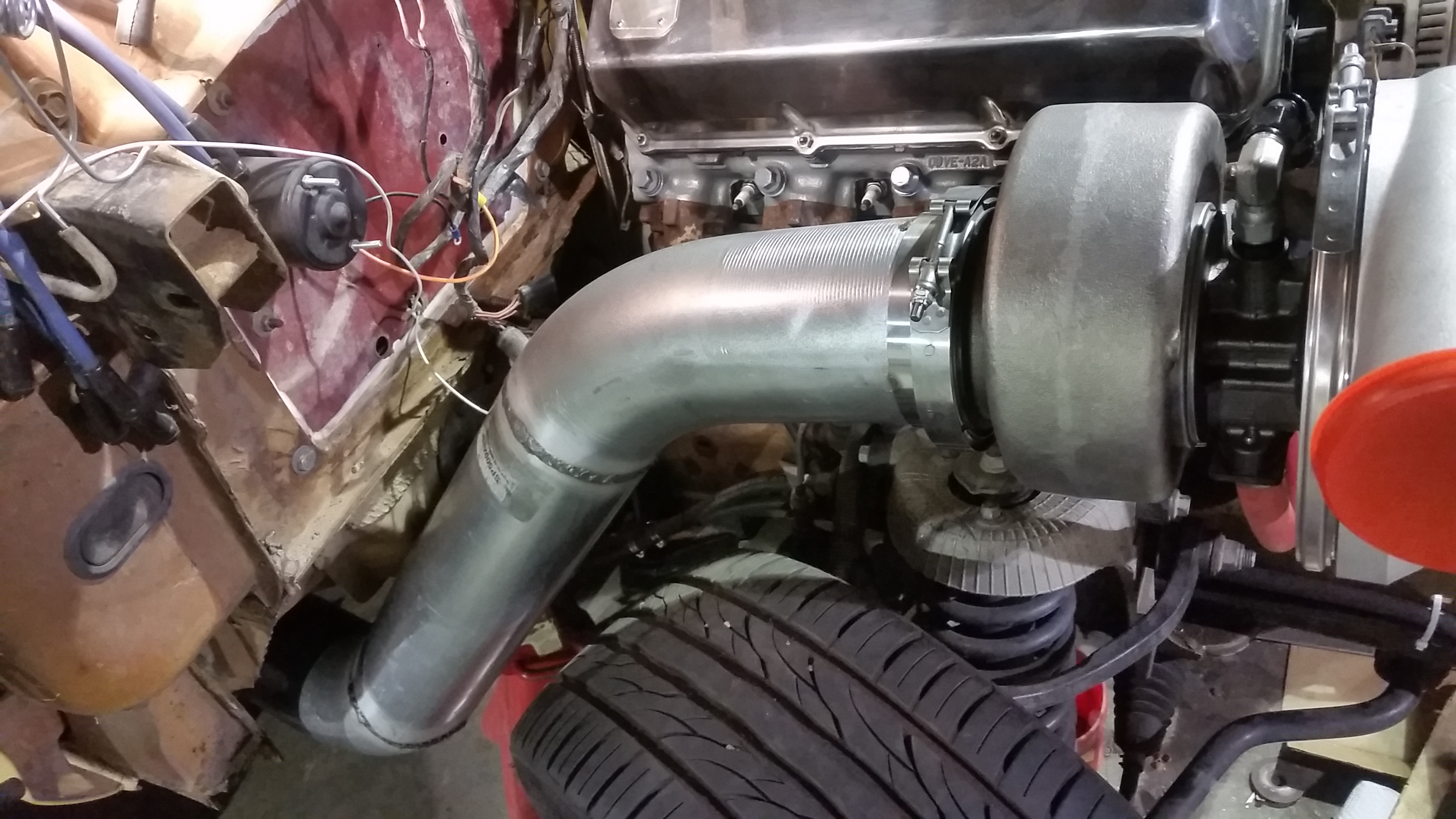

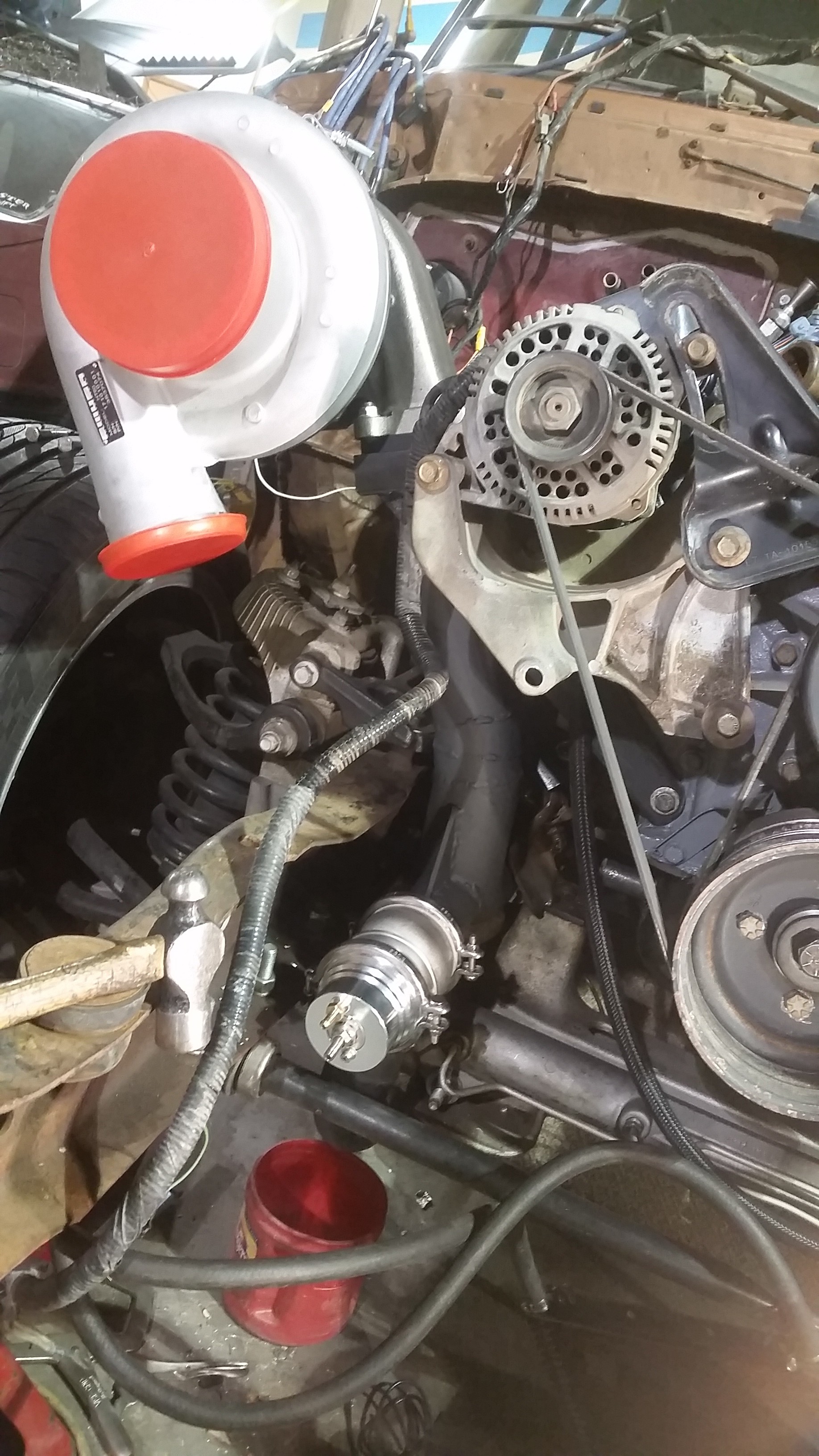

Hot side is finished and installed. Still need to make a down pipe, but that won't really be a big deal. Last pic is a little out of focus, but shows how well it tucks up under there while still allowing access to the starter, oil pan, and converter bolts.

I ordered a 90 deg bend with 18" legs and 2 36" sections of pipe. Should be enough to get it about where I want it.
I considered running it through the fender or just dumping it right behind the front tire, but that would probably be stupid loud. I think I am going to run it back and put a 5" resonator muffler on it because some streetcar-style races around here require exhaust past the firewall and a muffler, even for turbo cars/trucks.

Holy cow this stuff is big. Stapler for scale. Haha. Bought these aluminized parts from ebay seller "truck-trailer-direct". Very good prices, and free shipping. They got here quick too.

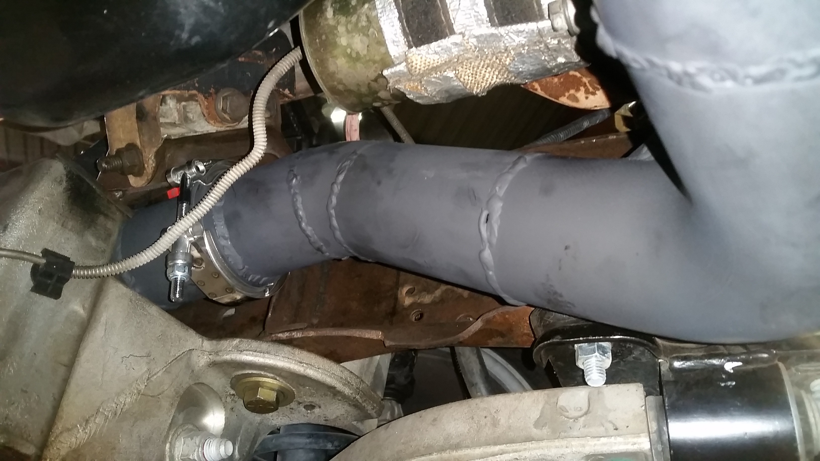

Friday evening I built the down pipe. It seems straight forward, but was a little tricky. The sheer size of the pipe made it difficult to cut with my chop saw and it is hard to just grab it and hold it with one hand. It needed one small dent to clear the cab mount a little better, but that's no big deal.
