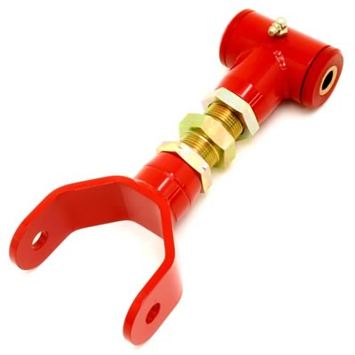

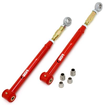

                      Free Shipping - BMR Control Arms with qualifying orders of $99. Shop Control Arms at Summit Racing.

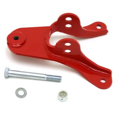

                      Free Shipping - BMR Lower Control Arm Relocation Brackets with qualifying orders of $99. Shop Control Arm Mounts at Summit Racing.

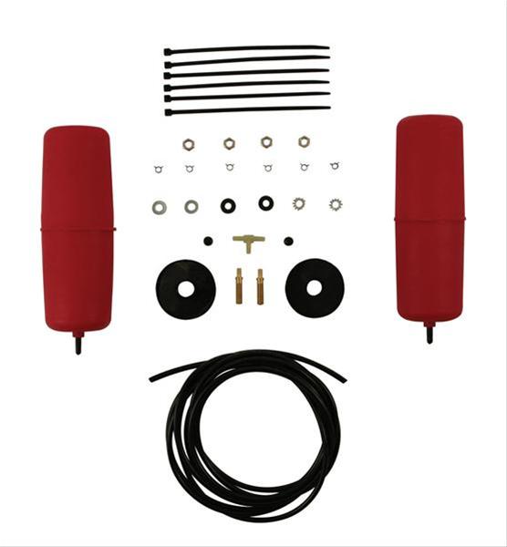

                      Free Shipping - Air Lift 1000 Load Assist Rear Spring Kits with qualifying orders of $99. Shop Air Spring Helper Kits at Summit Racing.
                      stock springs with air bags
                      running the bags left with 5psi, right 35psi
