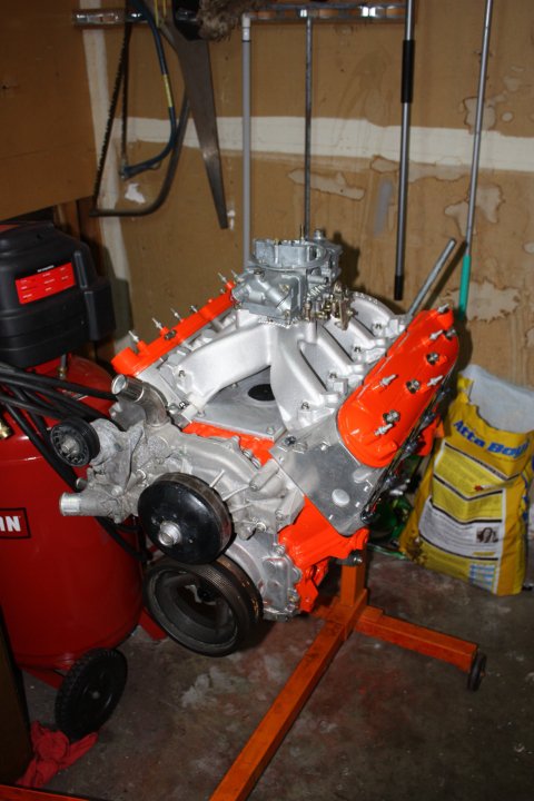

    4. The 6.0L Chevy motor that I already have will have to be fitted. With a pair of turbos and factory EFI. Thoughts of brand loyalty didn't keep me from looking for interesting cars, despite the feelings of others: http://www.bangshift.com/forum/showt.../41303-Purists

    Haven't double checked but I'm 99% sure it's the 9 inch. Wasn't aware of there being another option. As for the 4L80e, it should just be a cross member fabrication to get it to work. Tunnel should be plenty big enough. If not, wont have to grow by much. Largest issue I know of before even starting is the motor. I will have to run a front sump to clear the rear steer drag link. Looked at a few options so far, and the Canton racing sheet metal front sump pan looks like the option to solve that issue.
