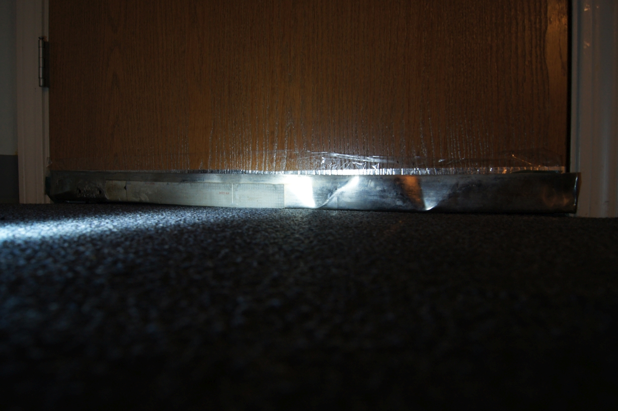

        my neighbor gene with the temper tantrums tells me when the pressure changes and it tries to kill him.
        this is what I did to may bathroom door. As you know bacteria is afraid of stainless. Especially toilet stuff.
        the place stays clean, it is the sheer pressure with invisible vapors.
        I can actually smell the killer now. it steals all food from the stomach in nanoseconds... just one whiff.

        this seals the bathroom away from me.
