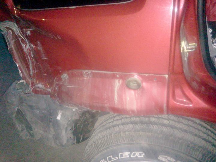

is this bad or real bad
    40 something k miles. Was mint. got hit backing out onto a fairly quick road.
    jeep liberty.
    everyone was ok.
    I caved in my sube forward of this spot, but its tin can. smashed it out and welded within 30 minutes. I hope its just the photos..but it looks like the tail end of rails may be shifted. Tough jeep 6k tow package dangling tough.

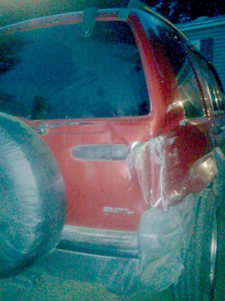

    this photo here. gives indication tail end shifted.
Name:	2012-06-12 20_47_42w.jpg
    other details I got were the hit was hard enough to spin the jeep around on dry pavement. yikes.
    attempt insurance or not? I voted for insurance..4 years old, 40 k miles. get that thing on a jig if need be.
    pro opinions? any opinion?

    what did it do to the door gaps?
    • tardis454
      • 3595
      x2 on the door gaps.
      A crappy body shop would pull the quarter & schmuck it with bondo.
      A good shop would install a new quarter or get a quarter cut from a junkyard.
        all good but the back hatch.
        this could be a tricky one. top squared..just down low did a shift.
        very very tough buggy there. They would still scraping body parts up if that was a ricer.
        obviously hit by a tall vehicle as well. both drove home.
        those frame hits, they become beamers. I vote a laser beaming pro gets at it.

          Are you thinking of buying it? I agree that it should go on a good frame rack. Also have them pull the body back. Even though you'll want a new quarter it'll fit better if the underlying structures are where they belong. I've talked myself out of the "straighten before bodywork" thing twice and hated myself both times. Never again.

            Jeeps can take a good hit .... it's not always what you can see that will "total" it. Frame rack 1st, then make the decision.

              its my parents. I won't be buying.
              if it is tweaked chassis I'll feel bad. I hope they get lucky on a diagnosis.
              that is the toughest brick I have seen. The chevy tracker they used to have was also a very dense little brick. the jeep is even tougher.
              the back end is easy for this stuff.

              the jeep just has a crossmember in the very end of frame and that twacked over, frame did not even lose dust... and the rear quarter and gate. inner and outer parts. All getting fixed. still drives smooth, no "shimmies".

                    real bad
                    I am humoring an update to this..
                    a quote of 7800.
                    it is tweaked. The place they went to can pluck a pretzel into show car, they must have found something frame related.
                    real shame.
                    attempting to be optimistic there was some years of high premiums and rates won't change. Rare luck there. most people eat this cost.
                    2007 inmaine is the beginning of the end for chassis, this one is going back to a pros version of brand new. Add five years to the little jeep like rewinding a timer.
                    another oddity in the bill is claming free rental car..but I could guess the 30 days they are keeping the jeep is another thing to look at on the bill.
