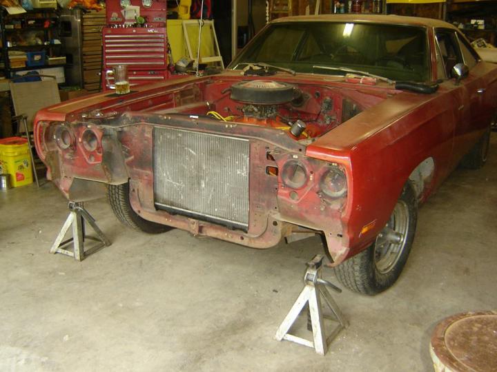

      Dan,
      I picked up a used radiator with two 12" diameter cooling fans in near perfect condition from a local salvage yard. It came from a Nissan 300ZX turbo and fits nicely into the original radiator opening of my Road Runner. I paid $40 for everything, out the door. Click image for larger version

        Couldn't help that. Sorry.
