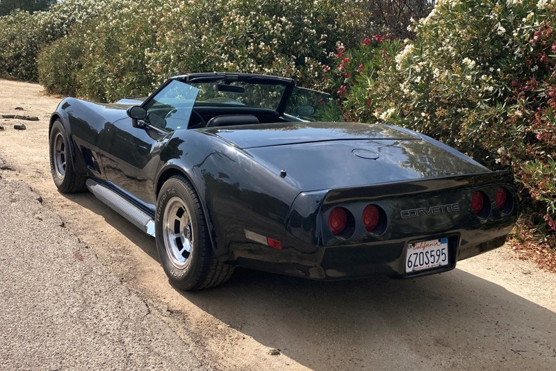

        Red/black interior 1984 TBI Corvettes keep following me home. They have no market interest and are dirt-cheap, while I personally consider them to be historically significant. I now have three. This is not crashed, just partially disassembled. 85K miles/garage-kept, but an automatic car so it'll get parted (kind-of a shame).
        Click image for larger version  Name:	IMG_2970.jpg Views:	0 Size:	158.4 KB ID:	1356768
        The first one I bought, which will be my "keeper" has well over 300K miles on it (speaks to some longevity) and there's a lot here it can use.

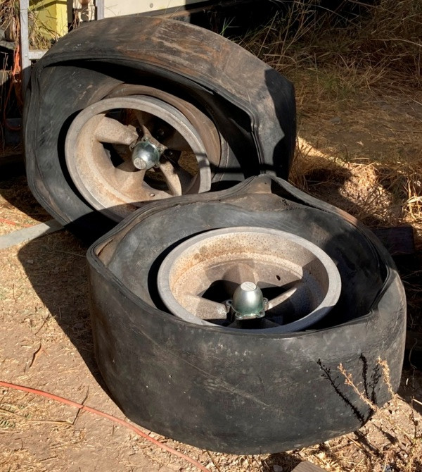

            And so I did, after some months of keeping an eye on the classifieds. These came from the son of the original purchaser from the late-sixties, they were on a '55 Chev, then lay out in the yard for who-knows how long. The outer-rim-to-mounting surface is 3/4" deeper than my re-pops, which I think will look good with the slightly-flared rear fenders and should work with 255/50R16 C4 'Vette tires. Now I get to re-narrow both sides of my rear suspension, that will be the next project, and the rims will need to have a little material cut off to get past the corrosion pitting and polish up (they are thick, heavy wheels and won't be bothered any). Slow progress.
