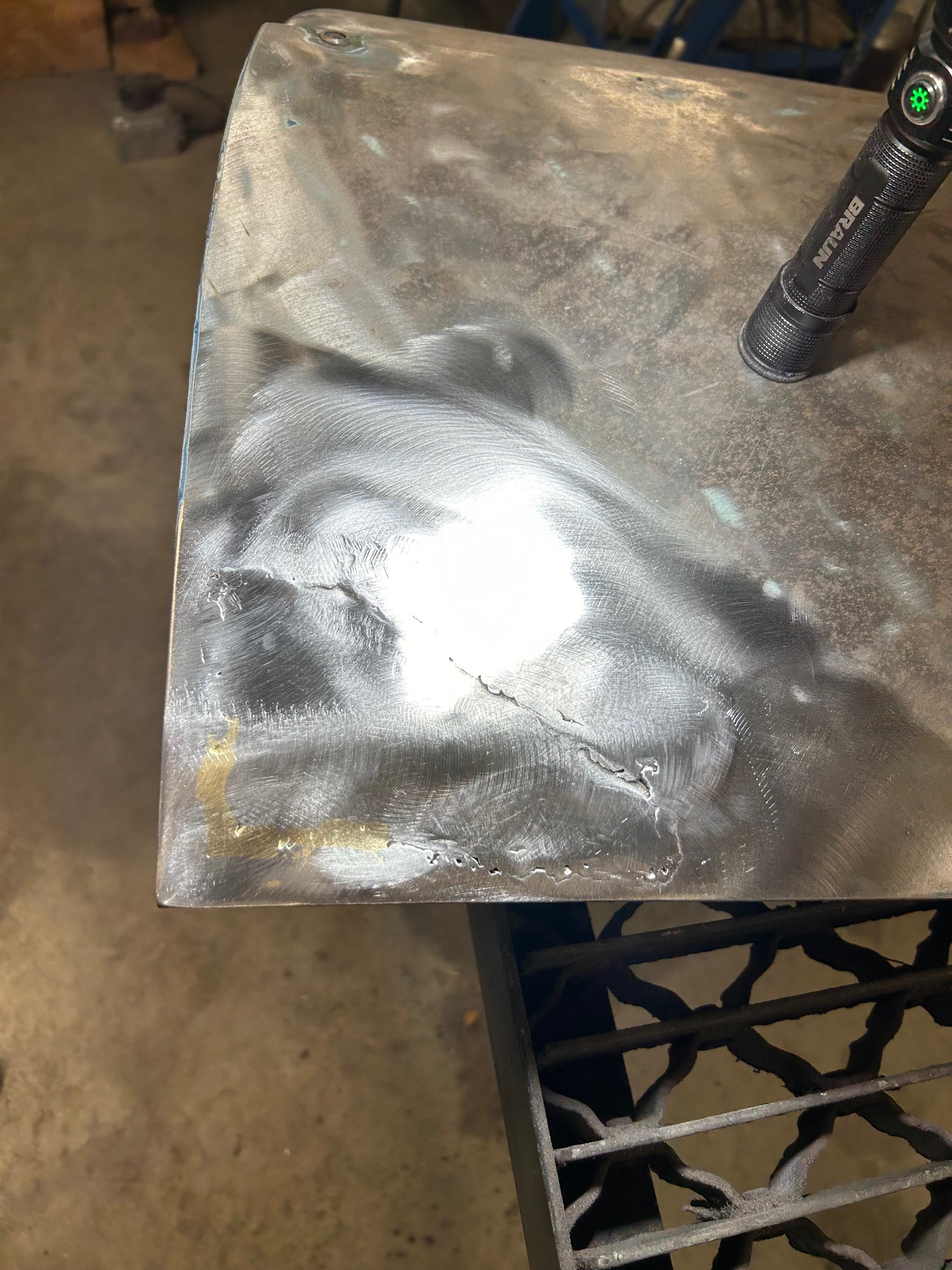

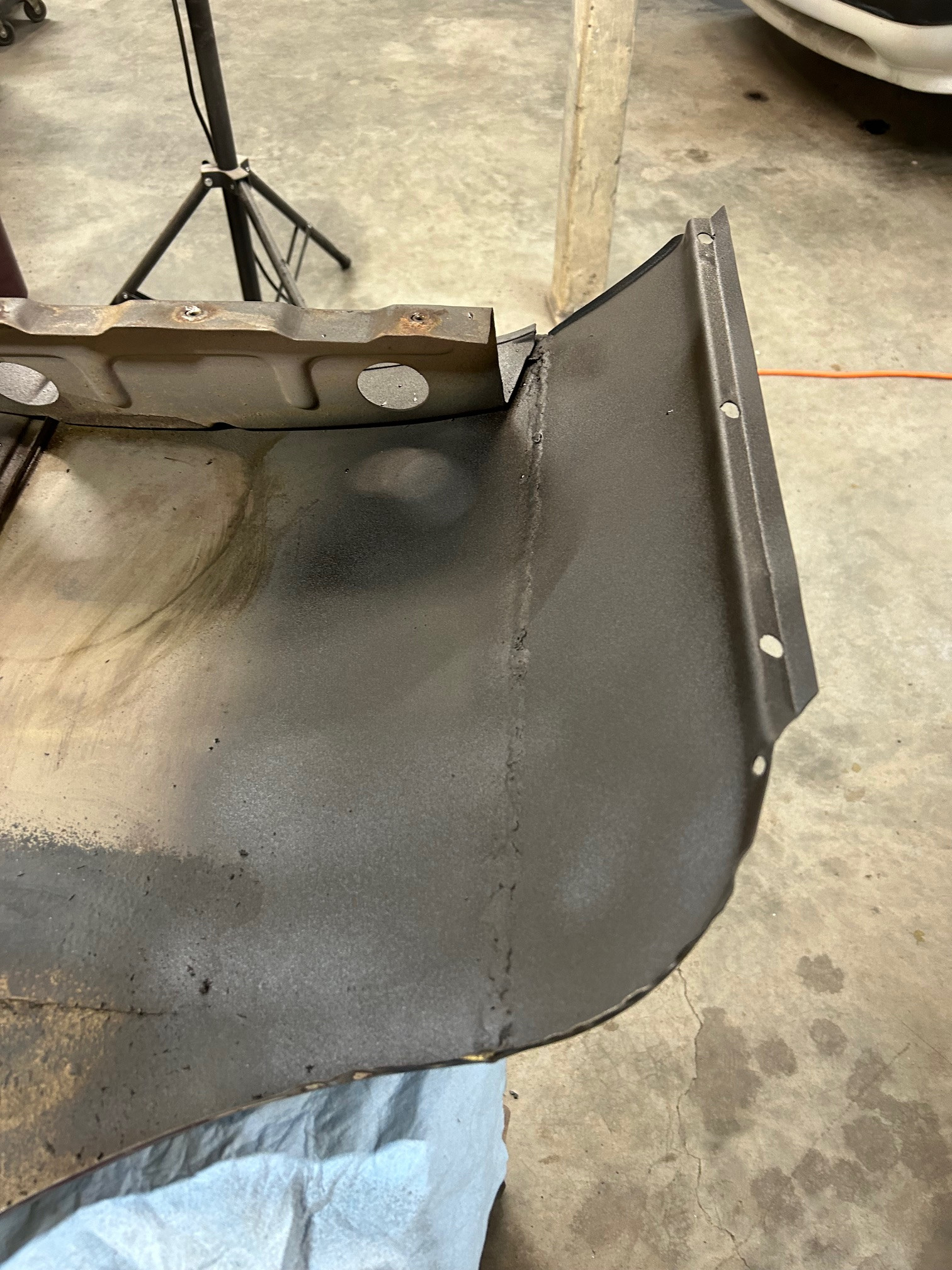

      As I wait for a rebuilt distributor for the Stang I figured I might as well move along on the MGB. I'm putting off bottoming the left fender until my trusty helper can be here (we're thinking next week sometime - I want him to see the process) so I fiddled with the right fender today. First of all I overbrazed the inside of the weld on the new patch. The weld was kind of pours and I didn't like that so the overbraze is an adequate solution. As I tried to figure out why the weld was so crappy I checked my MIG gas bottle and yep - it ran out at some point as I was welding in the new bottom. So Monday it's off to the welding store.
      A couple of pics to hold y'all over as I get back on bigger parts of the project. I primed the inside of the areas I welded on the right fender then coated those areas with spray rubberized undercoat. The hope is for everything to stay rust-free.
      The area where I welded out the side marker light:

      And the wend across the new fender bottom:

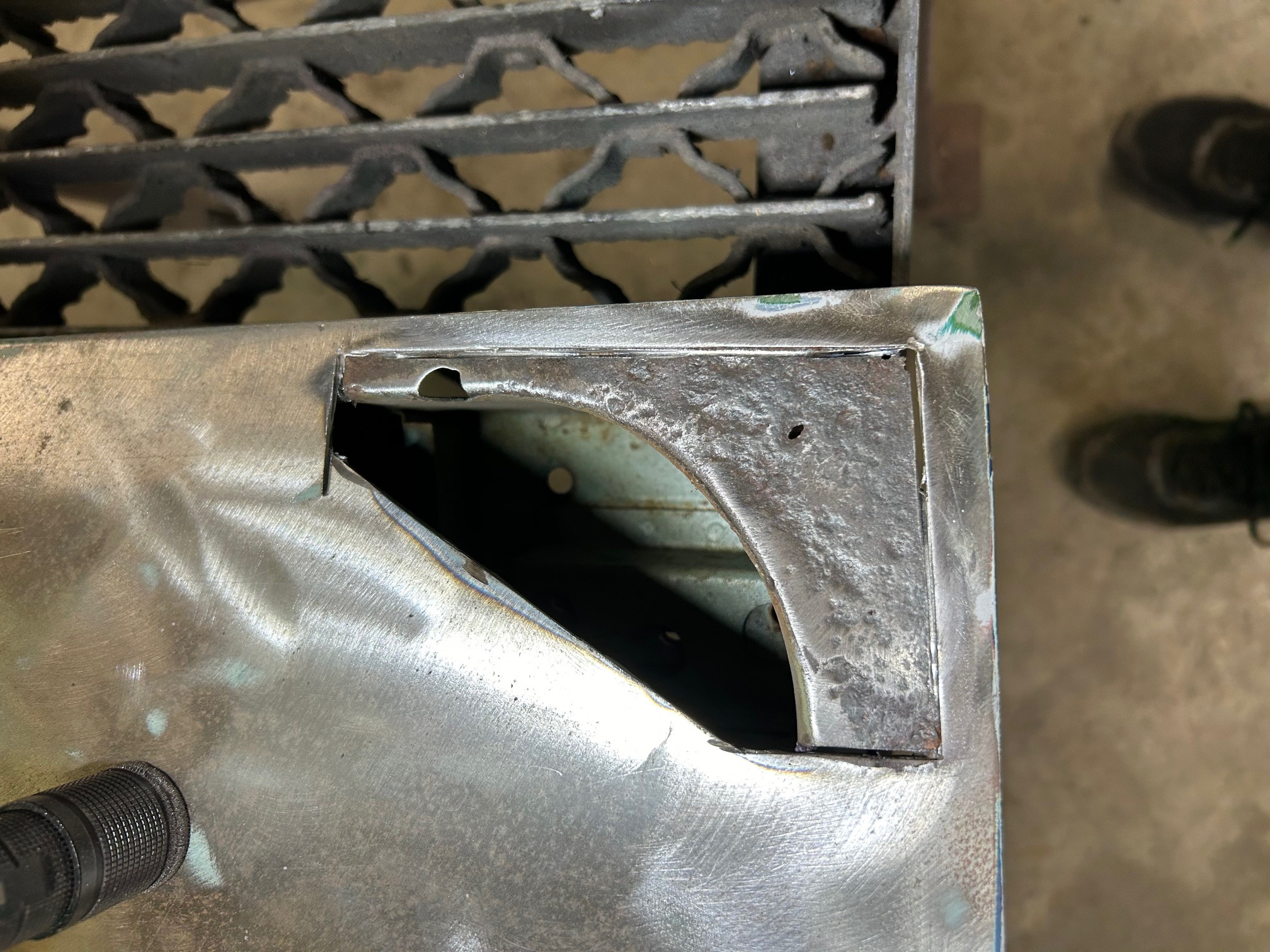

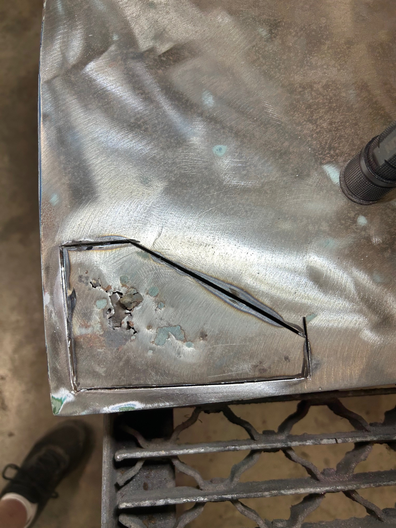

                  As I looked more closely at the right door it's been poorly repaired and I'll be better off if I can find a better candidate. Luckily, my guy in Monroe NC has some to choose from so I'll run over to Monroe area on Friday and score one.
                  I have a replacement left door in hand and it's pretty good but needs a front corner which is fairly common. So here's the fix:
                  The damaged area with the damage cut out:
                  Click image for larger version  Name:	IMG_2767.jpg Views:	0 Size:	922.0 KB ID:	1358527
                  And cut out:
                  Click image for larger version  Name:	IMG_2768.jpg Views:	0 Size:	841.4 KB ID:	1358528

                    In weld-thru primer:
                    Click image for larger version  Name:	IMG_2769.jpg Views:	0 Size:	886.8 KB ID:	1358535

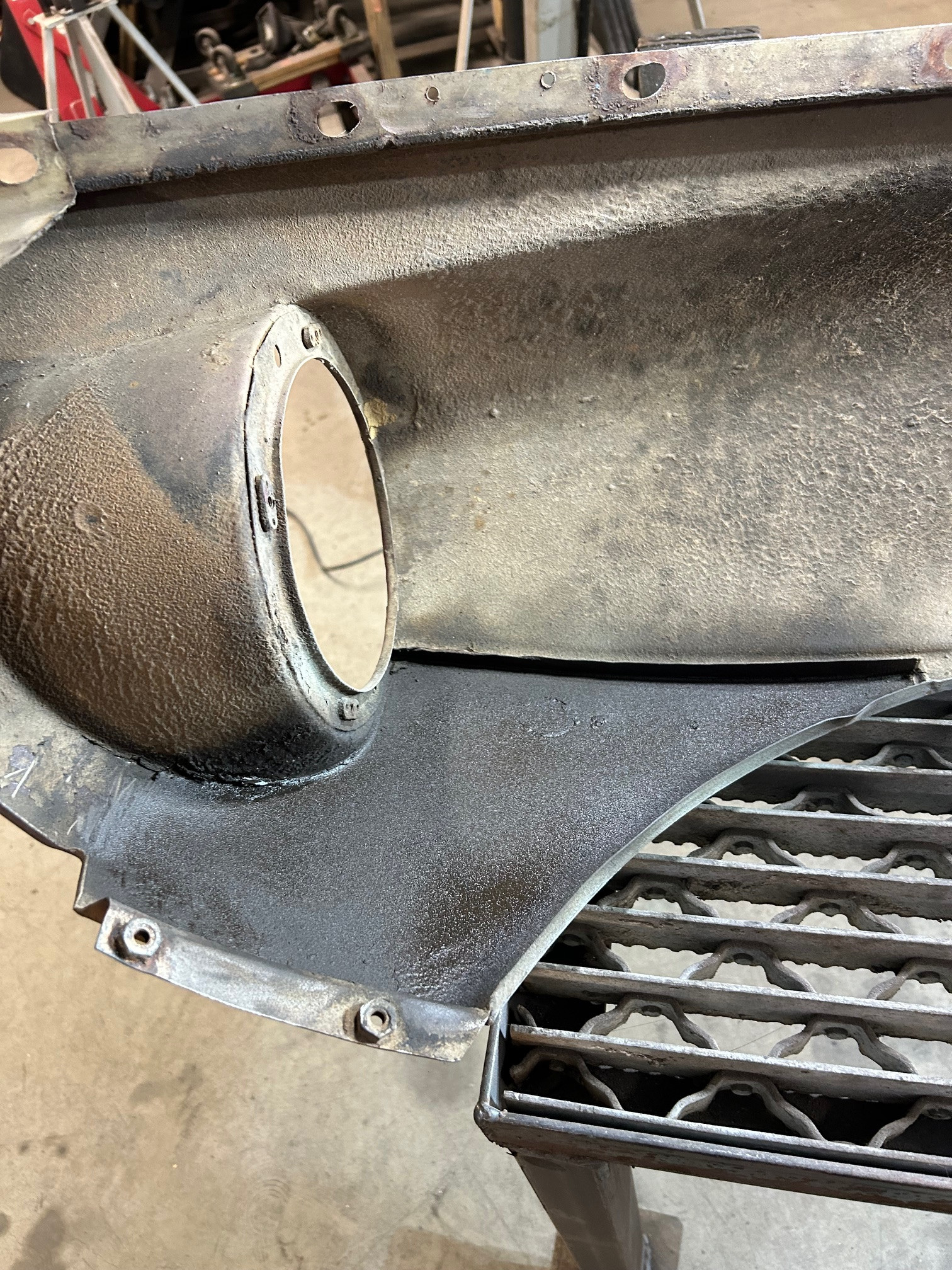

                    And mostly welded in. I inadvertently cut all the way thru the backing piece so I left that area unwelded so I could braze that and have the braze penetrate thru cut thru area. Pic to come.
                    Click image for larger version  Name:	IMG_2770.jpg Views:	0 Size:	986.1 KB ID:	1358536

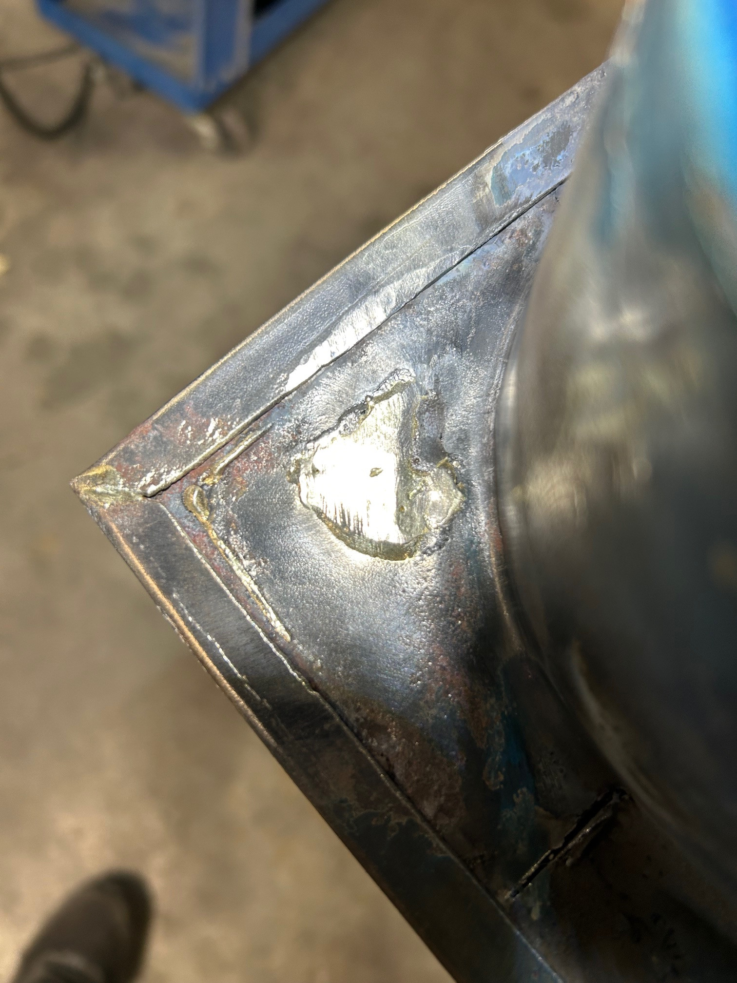

                    And from the back: Note the thin brass lines where the cut-thru was fixed. The brass blob is to fix a small area of rust thru in the backing piece. No one will see this as it's the front area of the door.
