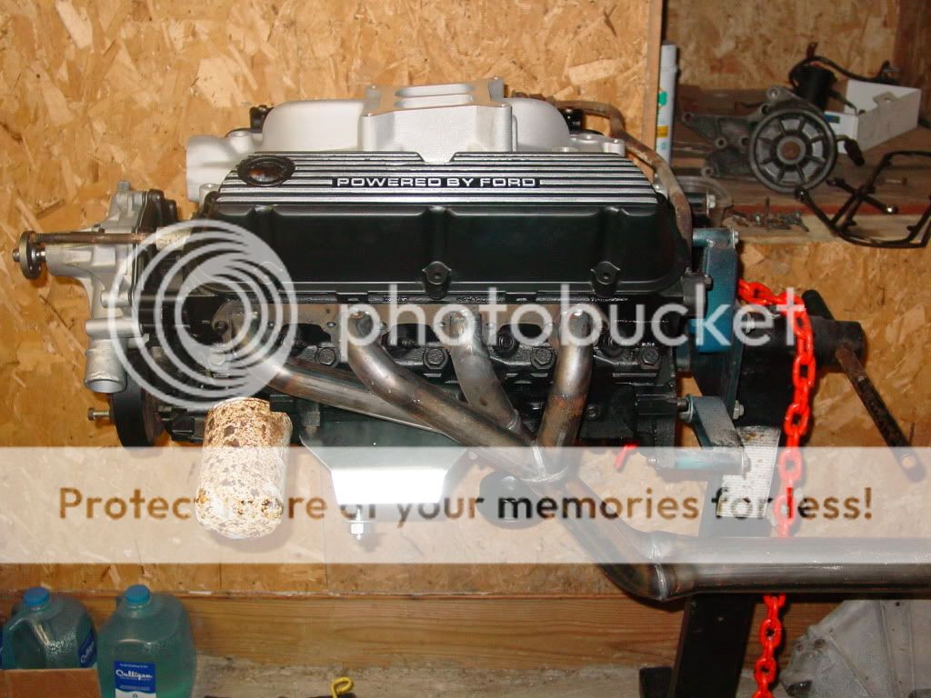

      The ranger already has "clearancing" for headers - wait till you see the mess of home built headers the 351c4v has on it now...
