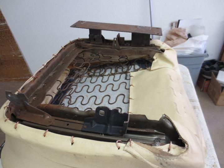

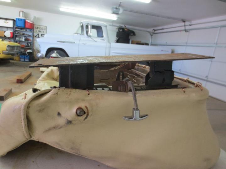

            Here are a couple pics of my seat brackets. I took the driver seat out to fix the springs and replace some of the foam, after all these years.
ID:	868933Click image for larger version
ID:	868932Click image for larger version
ID:	868934Click image for larger version
            The big plate on the outer side fits the original seat track mounting holes in the floor. The inner side uses a piece of angle iron welded to the floor, and the Pontiac seat bracket was modified to fit to this with two horizontal bolts. My seats are from a 64 pontiac, not a chevy, and they use different floors, etc.

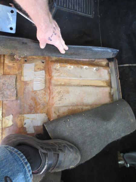

              I just ordered up the steel for my buckets today.
              My tracks are a little different than yours......I've got some U channel being bent, it's
              2" on top with 1" sides.
              This will go on top of 3/16" flat stock.......I have to raise the outer track about 1 1/4" because
              of the drop in the floorboard.
              Hope to start maybe this weekend.........will post up when I get started.

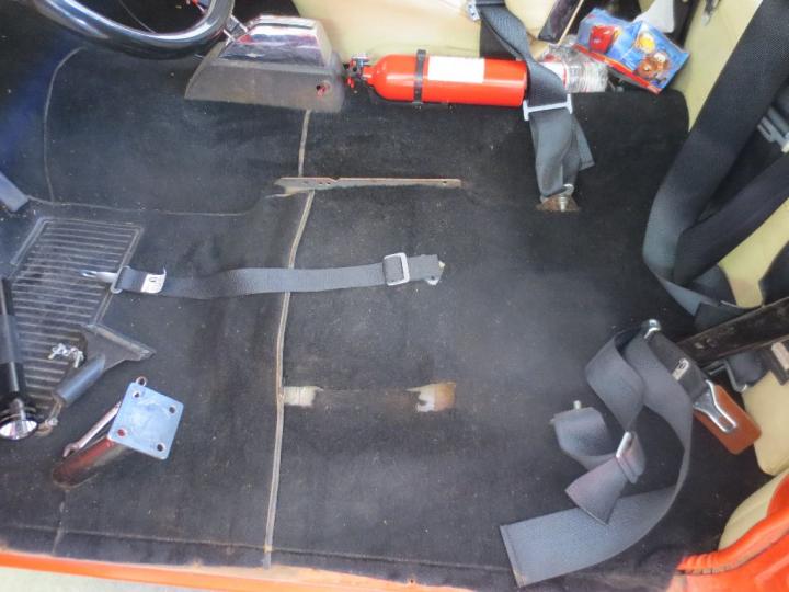

                              #899
                              Before
                              After
                                #900
                                You carpeted the garage?
                                They look awesome!
