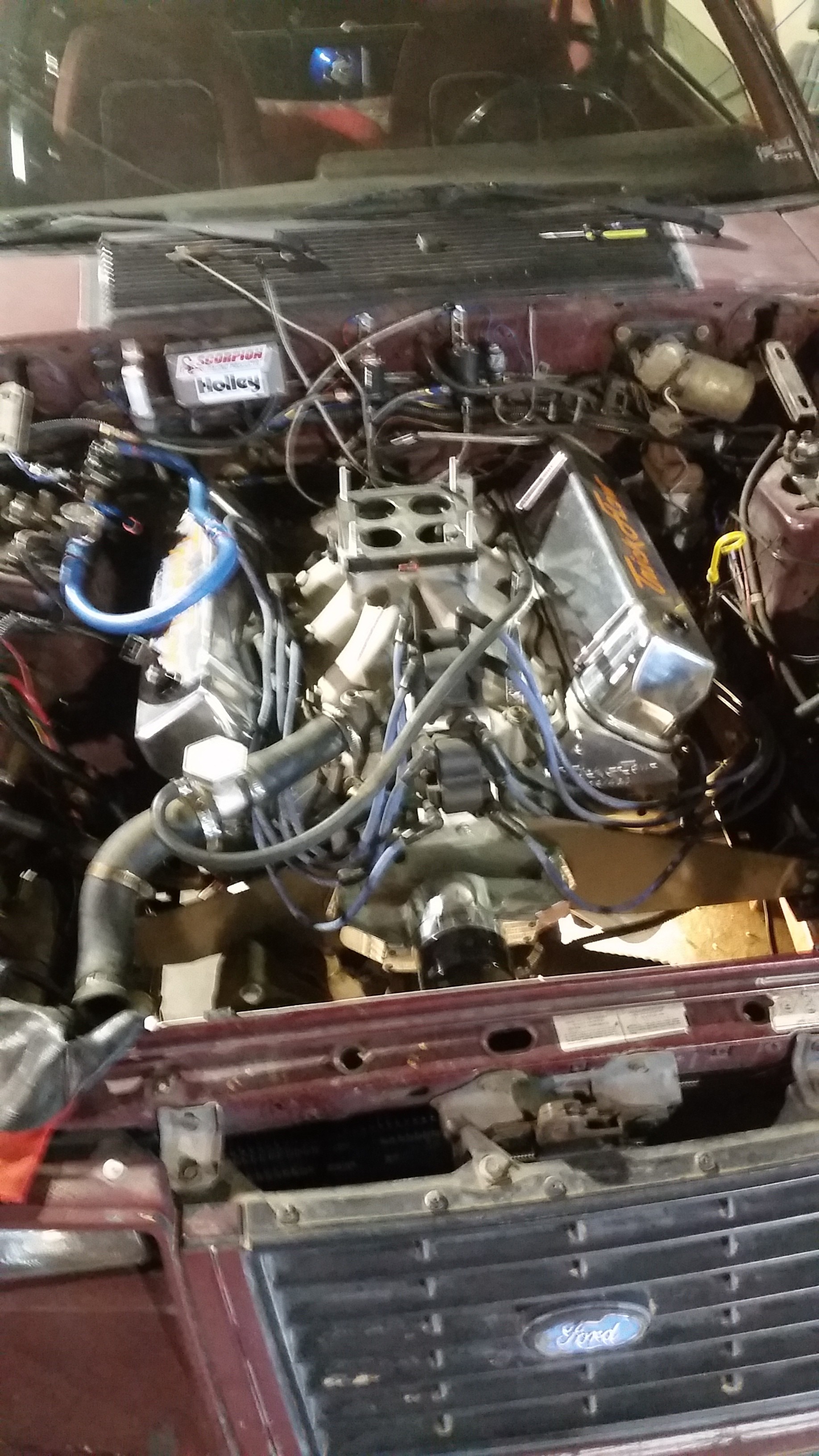

The transformation begins! Saturday we fired it up did a few open header burnouts, drained the coolant and backed it back into the shop. After a few hours we had the engine/trans ready to pull out. I pretty much just told the boys to "do this, and do that" and they did the work. So fun seeing them work together on something.
While they were wrangling the steering shaft, driveshaft and transmission crossmember, out of the car, I worked on the T5. I literally had to drive the shifter shaft out of the cover because of the rust accumulation. Once I had it out, I dressed it with a file and now everything slides together like it should. I did find a broken part. Not sure what to call it just yet. It's a "C" shaped piece of steel that has one part busted off.

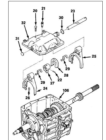

This is the little guy that is broken. I have had ZERO luck finding a part number or one for sale on the internet. Boo.

t4, t5 ... whatever it takes. Looks awfully familiar. In the exploded view on page 6, are you talking about item 5 ?Flying south, with a flock of bird dogs.Comment
That's part of that assembly........Patrick & Tammy
- Long Haulin' 2008, 2009, 2010, 2011, 2012, 2014...Addicting isn't it...??Comment
#28 in this diagram. I posted on FB that I needed one and have had several people say they have piles of them, but no one has offered to sell me one. lol
I don't have a spare, or it would be yours...Patrick & Tammy
No worries! One will turn up. At least I have a part number now! Thanks!
Edit: Having the part number was the silver bullet. (pun intended) Found one and it is ordered. Win!Last edited by BBR; December 19, 2017, 09:01 AM.Life is short. Be a do'er and not a shoulda done'er.
