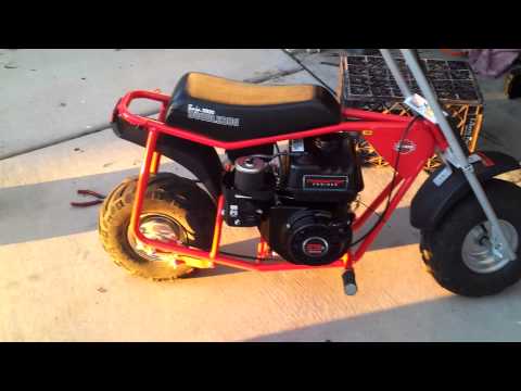

    And here is the new engine shoehorned into place.
    One thing that becomes obvious is the engine offset. The new one sits quite a bit to the right once the chain is aligned. It doesn't seem to make much of a difference in balance wen you ride it but it does make putting your right foot on the foot peg a little harder.
